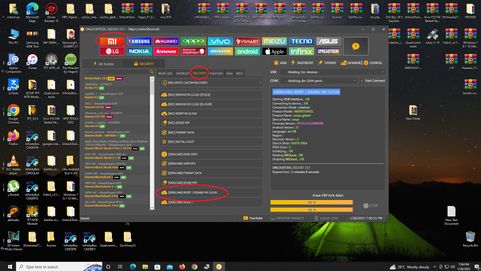

1.Open UnlockTool
2.Select Brand MI
3.Go to SECURITY and Select RECOVERY

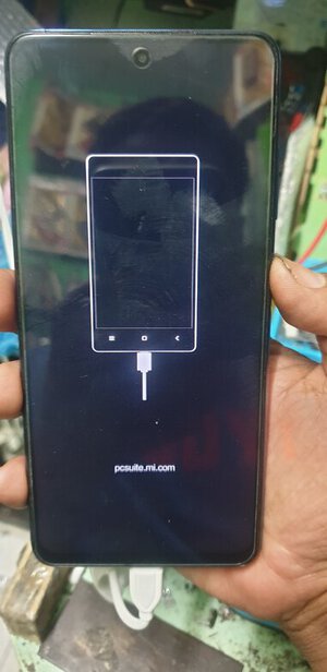

4.Connect USB Cable sa phone,
takenote: kung naka on si unit kailangan mo ma off para makapasok sa Recovery sundin ang sumusunod

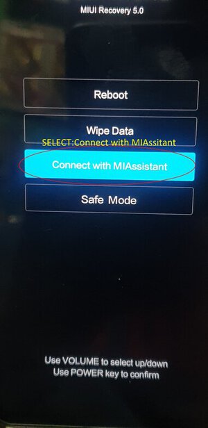

Press and hold Volume Up and Power pag nag off na si unit bitawan power and still pressing Volume up
hanggang lumabas recovery, then Select (Connect with MIAssistant) Click: power botton to ok,
kaialangan lumabas sa phone PCSUITE,MI,COM
paalala: po bago ipasok sa recovery kailangan naka connect na si usb cable sa phone
Check kung Detect na sa USB or computer device
5,Click [SIDELOAD] RESET | DISABLE MI CLOUD
at antayin lang matapos
pag may FRP or google Account
Same process Click Lng [SIDELAOD] ERASE FRP

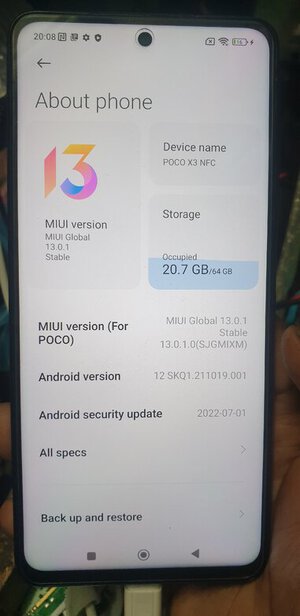

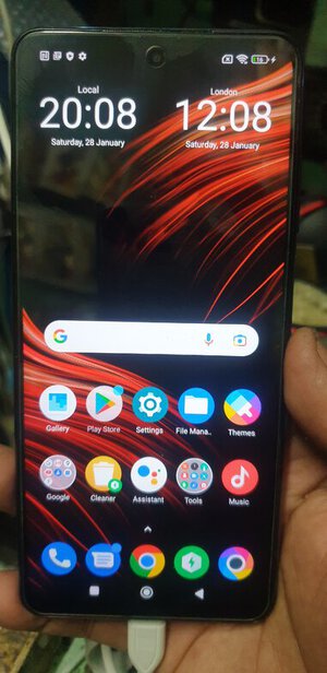

And Done.

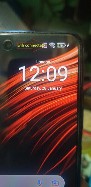

Fail sa akin master
