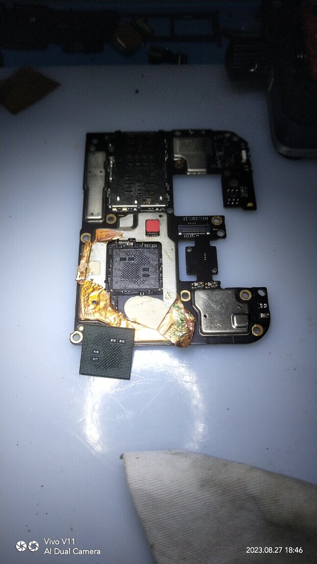

History.
Ibang scenario na naman..
Una Nag emergency call then nag no service and later on nag insert sim..
Ni restart ni client ayun no power na..
Check schenatic 0.3 dropping to 0.0 pa balik balik..

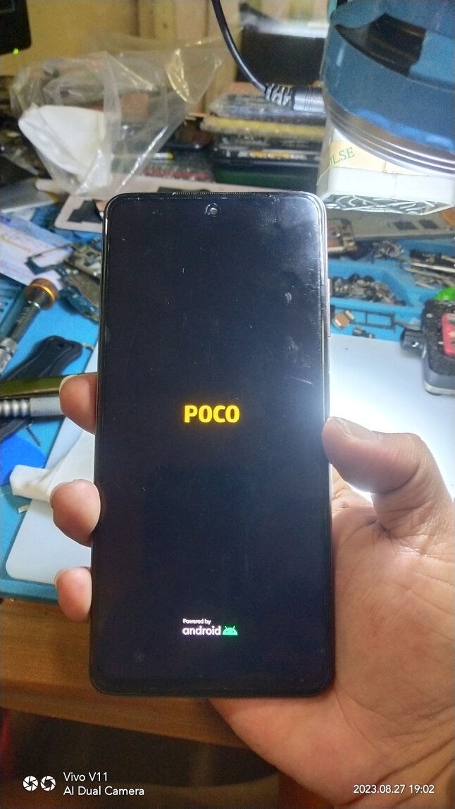

Power Supply Reading power switch pressed 0.069 reading after 2 seconds aakyat sa 0.137 mah stuck na jan..

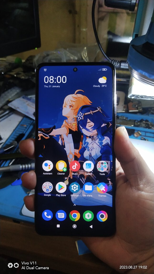

again CPU reball solution!!
ang procedure at guide na sa Reference kong post.
dito..
https://pinoytechnician.com/threads/xiaomi-poco-x3-pro-no-power-fixed.235866/
di ko na sana ipopost pero na isip ko ibang history kaya pwedeng maging guide uli sa lahat..
3500 pesos po singilan natin jan..
