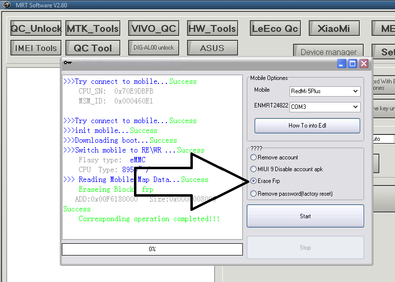

1st.

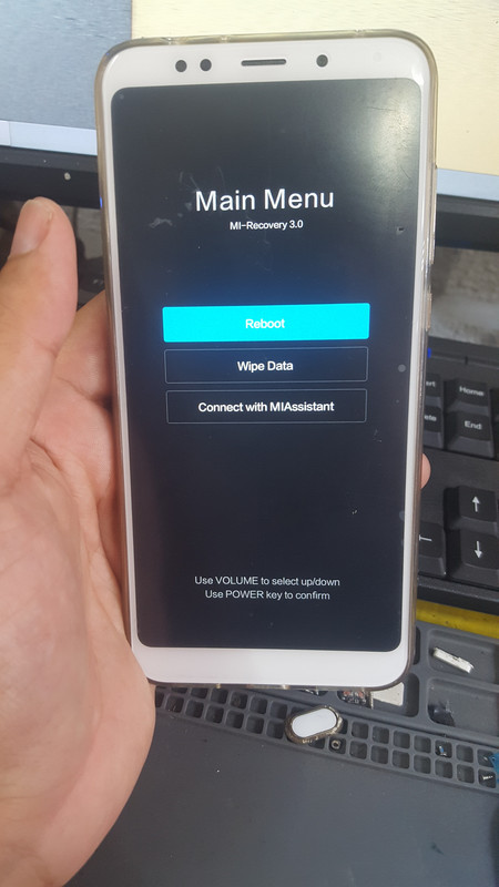

Ginawa ko po first hard reset
Sabay pindot ng (Volume + at Power Buton)"Couple of Second
2nd.

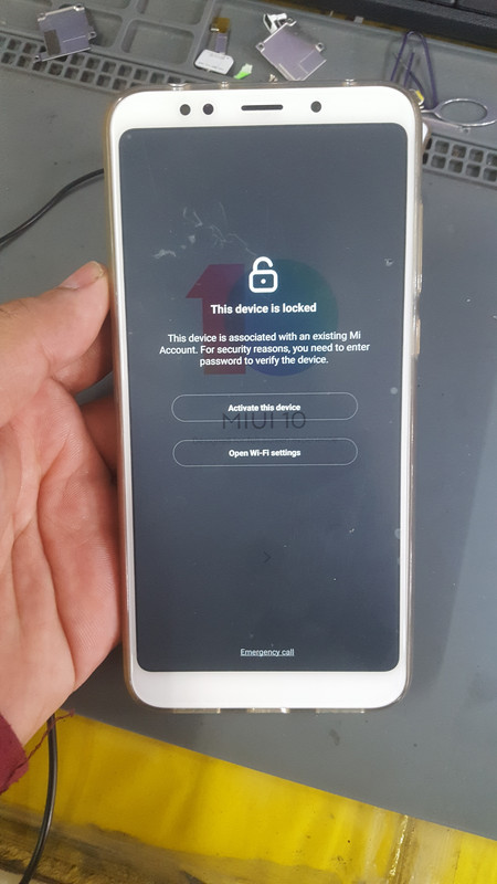

May lumbas agad Mi Account

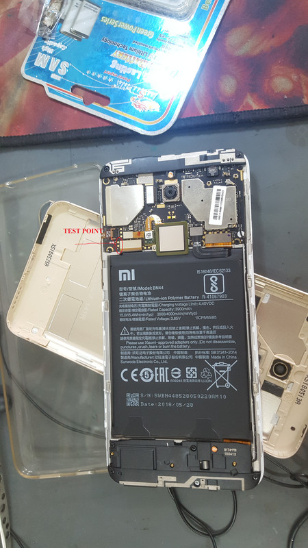

3rd. Baklas ko unit
Test point nadin at check kung binasa sa mrt

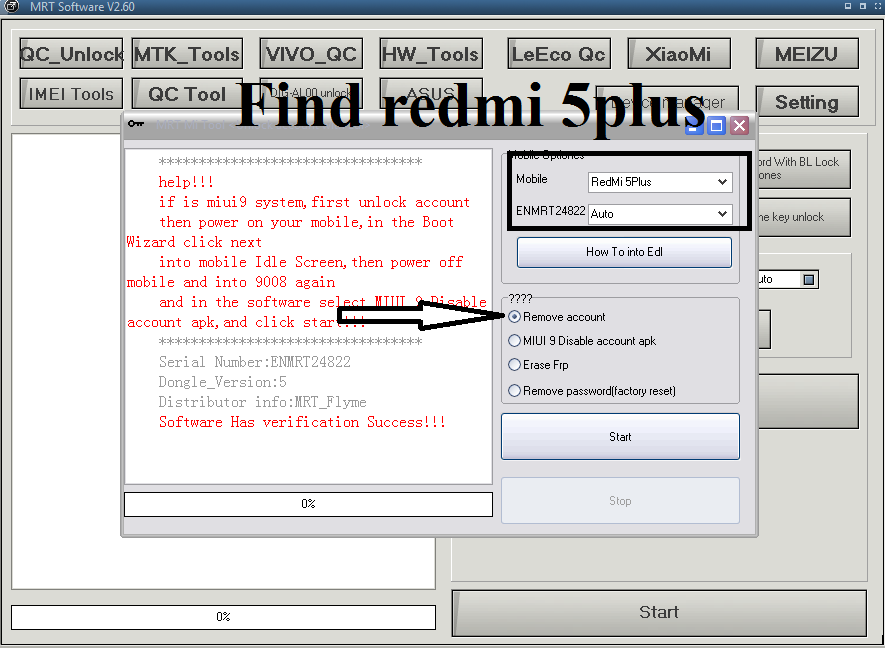

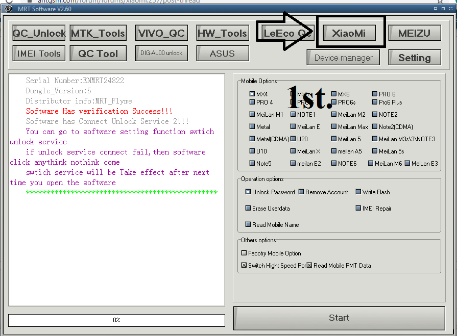

4th. Open MRT Click XIAOMI (HIT XIAOMI Account Remove Tool and FIND (Redmi 5 Plus)
Pag okay na test point Tick Remove Account
top baby names 2001
upload photo website

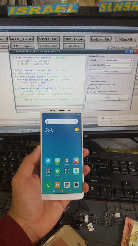

5th. Eto na Hit Start. Success ang ating pag tangal ng Mi Account. kaso may Google account naman.
starting salary for forensic anthropologist
6th. Earase FRP Naman
7th. Finish Product
8th. Singilin si customer. Hehehe
Salamat mga ka ant
Sana makatulong sa inyo
#Bulacan Chapter
na try ko ito procedure after connect wifi balik sa dati, need pa tirahin ng xiaomi relock fix or anti relock
complete procedure at madaling masundan yung thread mo sir... keep on sharing...good luck..
