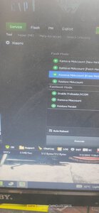

Tools
Hydratool
Usb data v8 cord
Pc/laptop
Producer
Select model
Xiaomi / redmi 6A or 6
Boot info

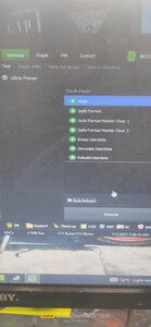

Boot key volume up and Down
Ultra option
Auto
Uncheck auto reboot

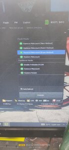

After that select XIAOMI TAB SELECT REMOVE MIACCOUNT(ERASE METHOD)

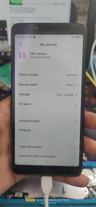

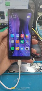

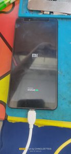

Check auto reboot ... After done ayaw mag reboot power on or unit remove usb cable then power on ...
See the picture below IMG_20220708_142228.jpgIMG20220708140449.jpgIMG20220708140434.jpgIMG20220708140438.jpgIMG20220708140707.jpgIMG20220708141340.jpgIMG20220708141352.jpg
