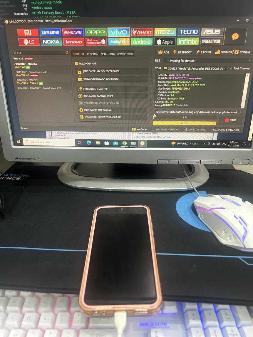

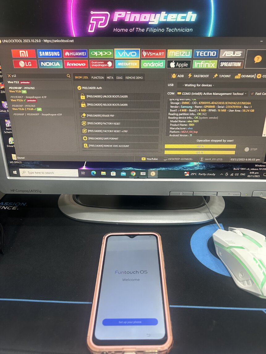

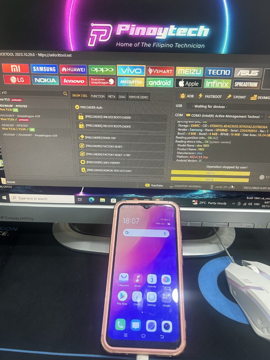

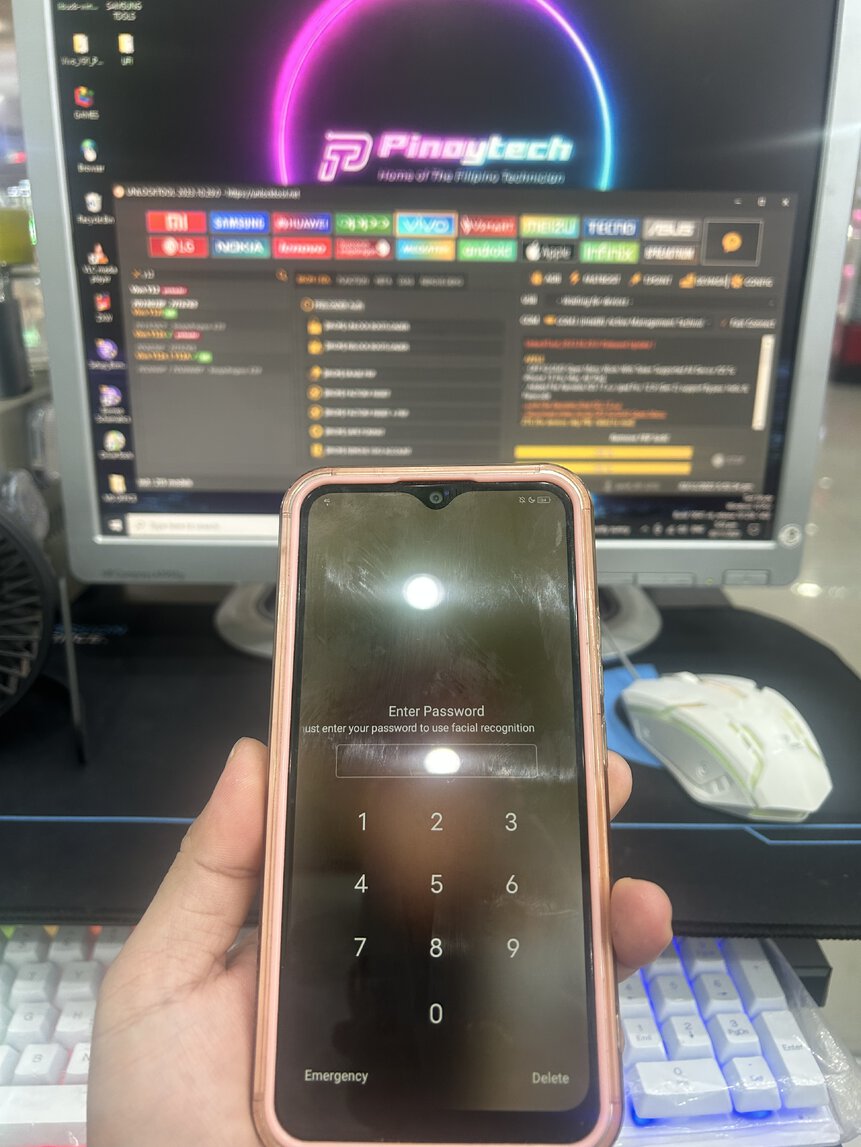

Share ko lang Vivo Y12 hindi matandaan ang password pati gmail account.
Procedure and Screenshots:
1. Open Latest Unlocktool and Tick on Vivo Tab
2. Type Y12 or search tab ang choose Vivo Y12 preloader PD1901-BF - MT6765
3. Tick [Brom] Factory Reset + FRP
4. Connect phone and wait till finish.
Thanks for viewing!
Good Day mga idol!
View attachment 29842View attachment 29843View attachment 29844View attachment 29845
Thanks for viewing!
