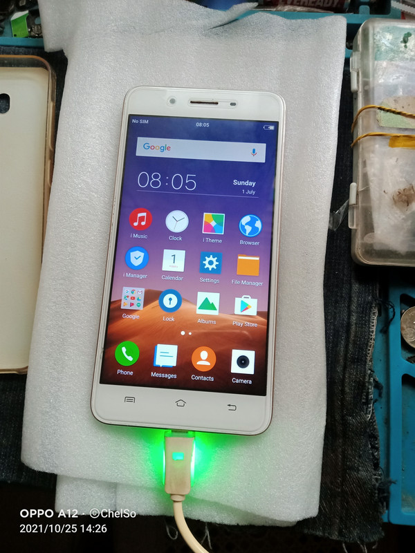

Naka bootloop/restart on vivo logo yung unit na pagawa sakin,Proven Tested yung firmware via sd card update,salamat po sir
