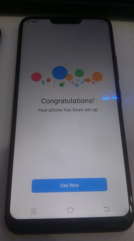

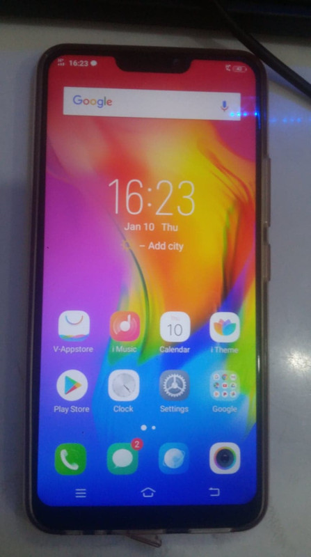

Y85 VIVO 1726 password& FRP Done

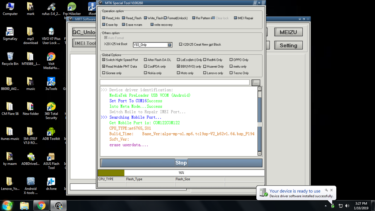

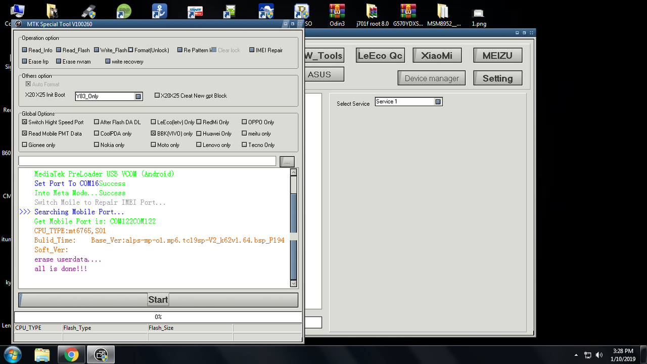

tolls: mrt dongle v2.60
procedure:
click start button sa mrt at para ma detect metamode long press volume up. wait lng mag run.
Hindi pa Done may FRP pa:((

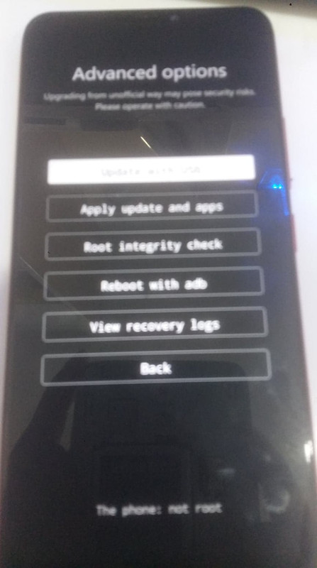

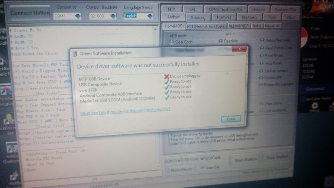

para nman sa FRP
hold po natin ang vol up at power hantayin mag recovery at hanapin ang advance mode at hanpin adb mode at open miracle crack v2.27a tick po natin ang android at motorola frp antayin madetect ang phone at smile na
