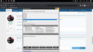

try ko boss salamatboss try mo format sa ibang software or di kaya sa software na hindi crack
salamat dol try ko toito dol try mo pasok sa thread "UnPack ME v0.1" new free soft, supported kasi ang unit na hawak mo
==> https://www.antgsm.com/forum/threads/unpackme-0-1-free-for-all.229946/
ibang FREE soft dol try mo kaya safe format
paki explain anu klase full flash at firmware boss para bago masara help thread mo eh mailink mo file at toolok n mga boss nag full flash ako.. salamat![]()
boss pasuyo paki update kami anu link at toolok n mga boss nag full flash ako.. salamat![]()
