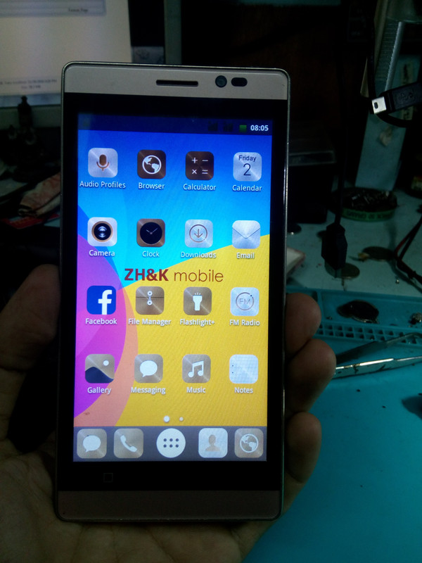

ZH&K Pioneer 7 pattern done via dragon crack
ramtech
Jul 23, 2017
104
6
PIONEER 7 format done via Dragon crack''

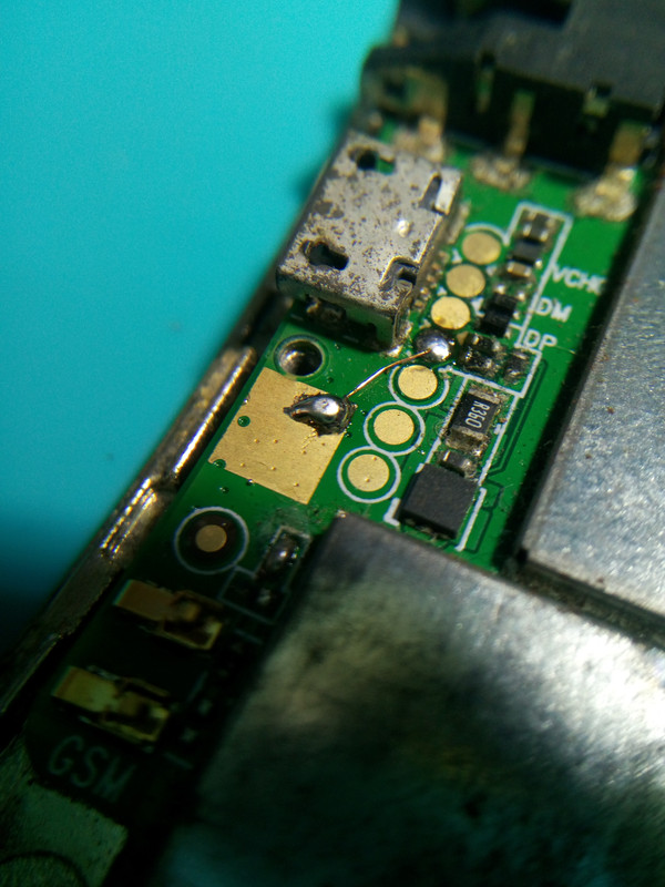

make jumper this line see the pic with jumper wire

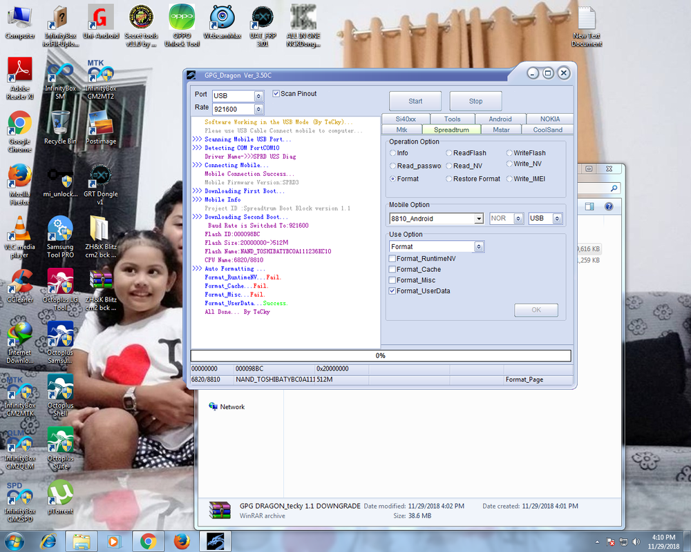

yan po kc ung boot nya para madetect..and hold volume +nsa picture napo procedure.
Screenshot;;
take note;;after ng format tanggalin napo c jumper
