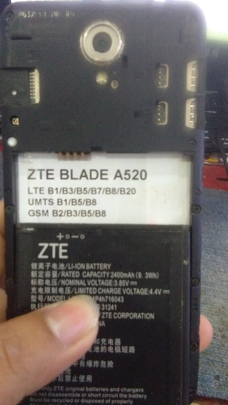

ZTE Blade A520 FRP Lock Remove – SP Flash Tool

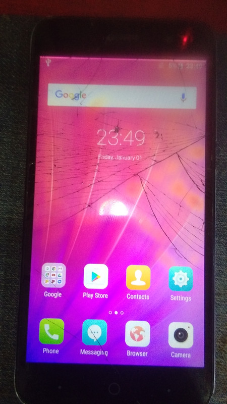

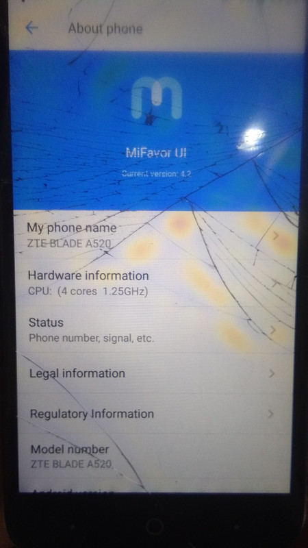

sensya di ko nakunan pic ang unit nung naka frp lock pa xia
pero tested talaga ito

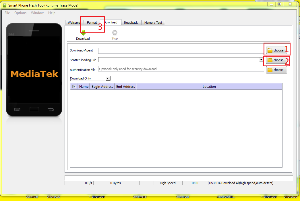

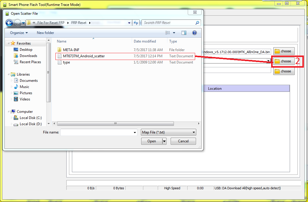

open sp flash tool

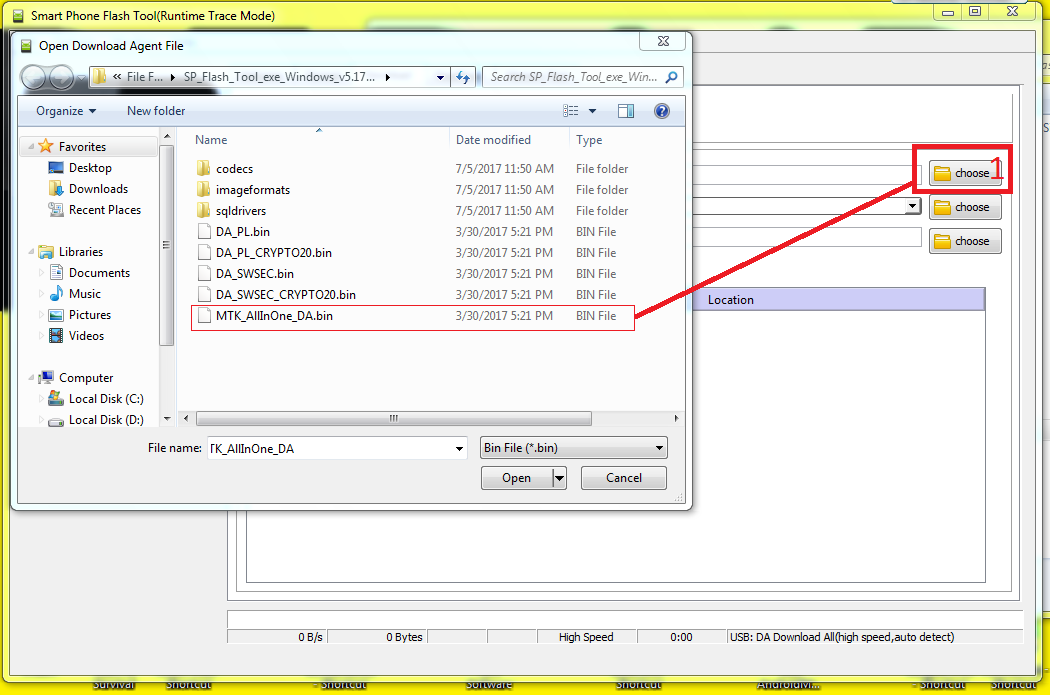

load download agent
load scatter file

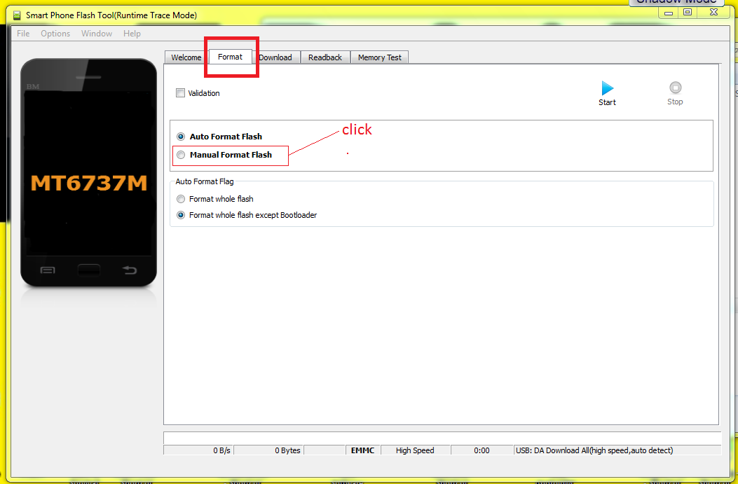

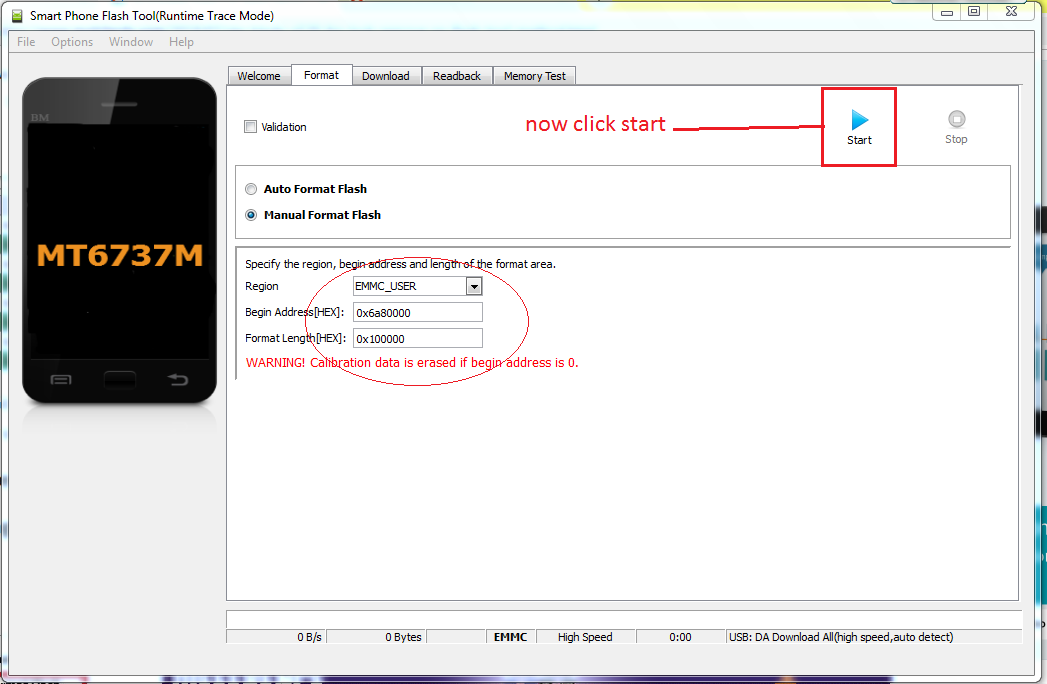

go to format tab

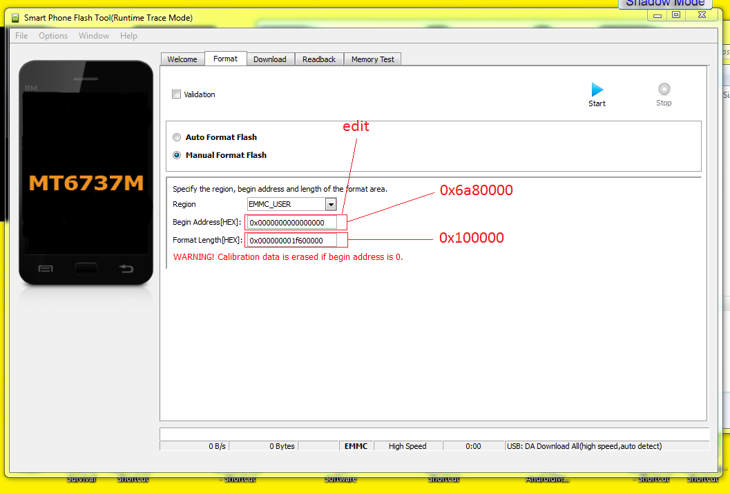

edit the hex
check the hex if it is correct

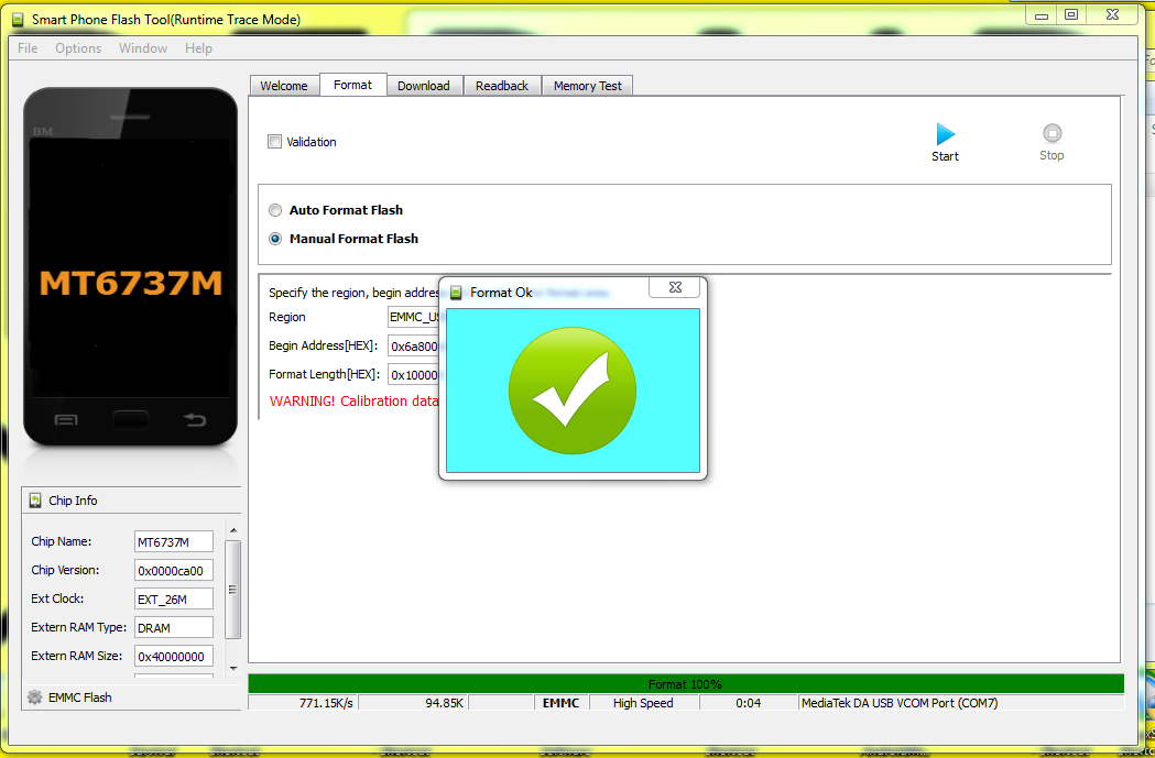

now click start
power off the phone
press and hold vol down key (-)
then insert cable
and done

kung di gumana sa vol down key. try nyo both vol down and up key para mag detect

open sp flash tool
load download agent
load scatter file
go to format tab
edit the hex
now click start
power off the phone
then insert cable
and done
