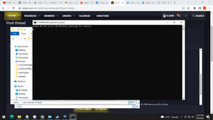

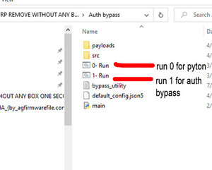

    0 - run muna para ma install ung python (HINDI GAGANA UNG aUTH BYPASS PAG DI ITO ININTSTALL 1 TIME LNG NMN ITO PAG NA INSTALL NA)
    tapos run
    1- run para sa bypass
    • Pag nag run na dapat ganto itsura nyan

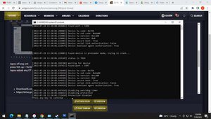

    tapos off ang unit
    press VOL up + Vol Down
    tapos salpak ang CP
    NOTE: WAG NA BUBUNUTIN PAG NA UNLOCK NA YONG PHONE

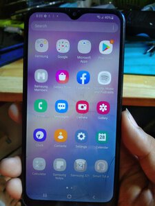

    • START FLASH
    • DONE FLASH

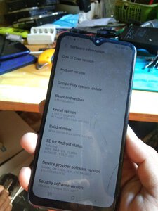

SANA MAKATULONG...
