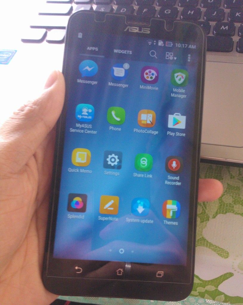

Share ko lang ito.
Dinala ni tomer saken na hang sa logo, di magrecovery nabalik ulit sa droidboot pag sineselect ang recovery mode.
First attempt - DOWNLOAD RAW Firmware then Asus flash tool ginamit ko pero di magflash, nageerror (frp request failed daw) may google account siguro ang cp.

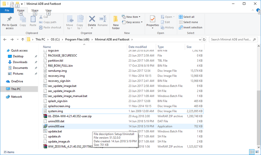

Second attempt - Nagbrowse ako kay google, rename to .zip ung raw firmware then extract. Mano mano natin ifflash ung laman ng raw
Download ka muna adb fastboot kung wala ka pa in my case, minimal adb and fastboot ginamit ko CLICK this para madownload mo. then dun mo eextract sa directory ng adb fastboot ung laman ng RAW. Check the pic.

Phone will successfully reboot into system. don't worry, first boot gonna take a little longer time. so have patience and watch some funny video till phone boots up.
Finish!
Alternative way lang to incase nageerror si Asus Flash Tool. :)
