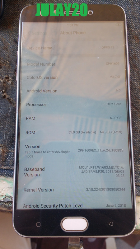

CPH1609 OPPO F3 Password and Frp Done

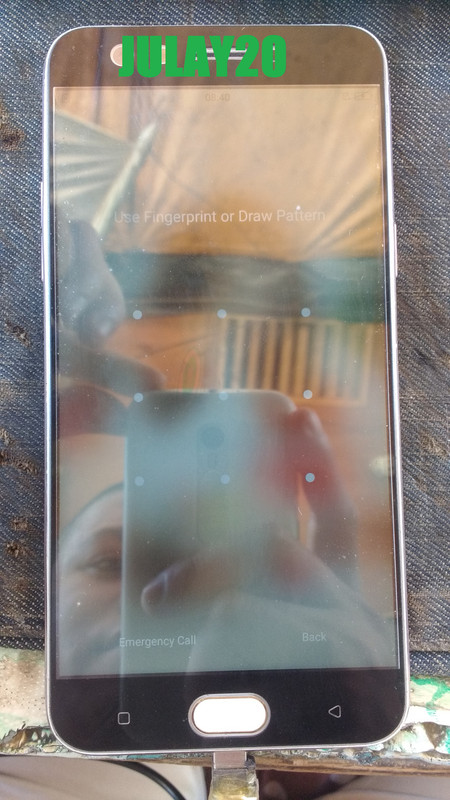

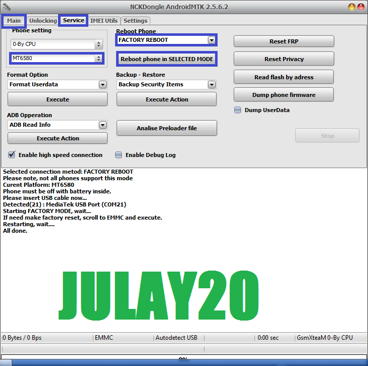

alam ni tumer yung password dahil pinakilaman ng bata ayaw na daw ma open kahit anong pattern kaya papa tangal na lang ni tumer yung password ginawa ko ganito :D
Tool's
NCK Crack
Miracle Thunder Crack
password mona gamit ko NCK Crack
LOG:
Code:
 Selected connection metod: FACTORY REBOOT
 Please note, not all phones support this mode
 Curent Platform: MT6580
 Phone must be off with battery inside.
 Please insert USB cable now...
 Detected(21) : MediaTek USB Port (COM21)
 Starting FACTORY MODE, wait...
 If need make factory reset, scroll to EMMC and execute.
 Restarting, wait....
 All done.
Procedure:
Open nck crack
click Main select MT6580
click Service
select factory reboot
click reboot phone in selected mode

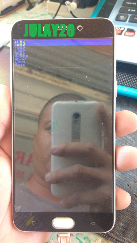

saksak usb power on unit para ma detect ng pc
pag na detect na power off unit saksak usb
hold voll up and down hayaan mo lang
my lalabas na chinese piliin mo yung my MMC
us voll down select MMC us power button kosa mag reboot yung unit hayan mo lang :D

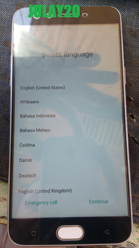

pag ka tapos ma reboot ito na sya
picture:
my frp o google account
my account si tumer pero ayaw tangapin ng unit :D

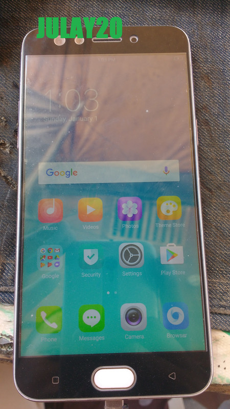

ito na sya
picture:
Done for reference lang mga boss sana maka tolong
