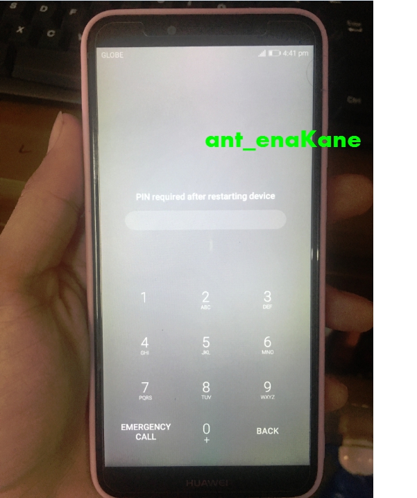

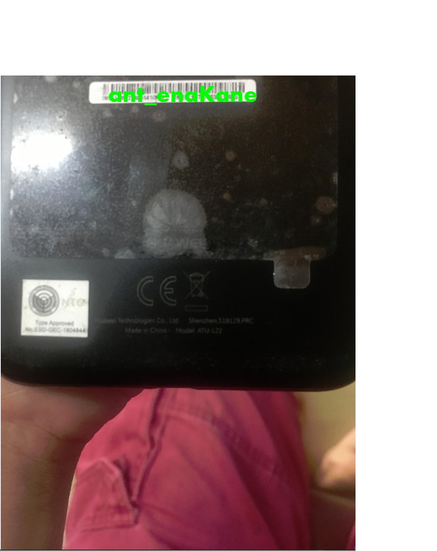

UNIT: Huawei Y6 2018 / ATU-L22
ISSUE: Forgot Password
SOLUTION:
OFF UNIT

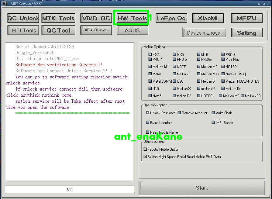

OPEN MRT

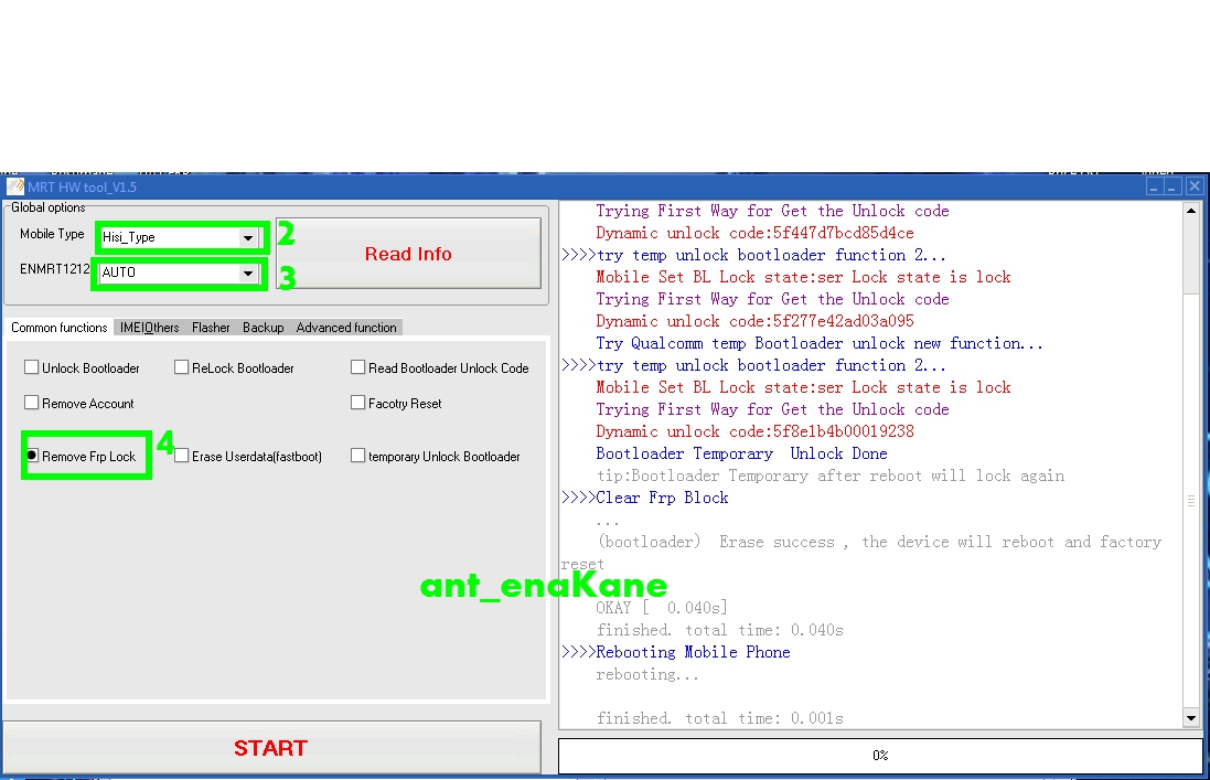

CLICK HW TOOL
SELECT AUTO
SELECT HISI TYPE
SELECT REMOVE FRP LOCK

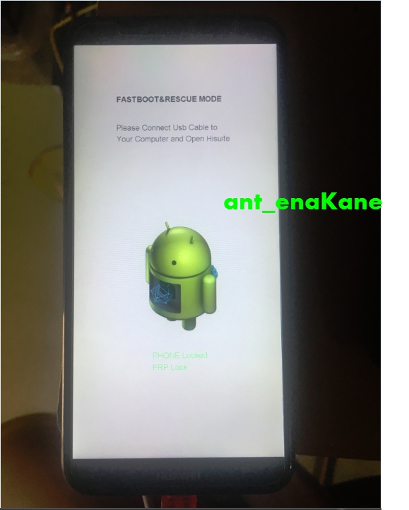

HOLD VOLUME DOWN, SALPAK SA COMP. (mag fast boot yan)
(hayaan mo lang mag install driver)

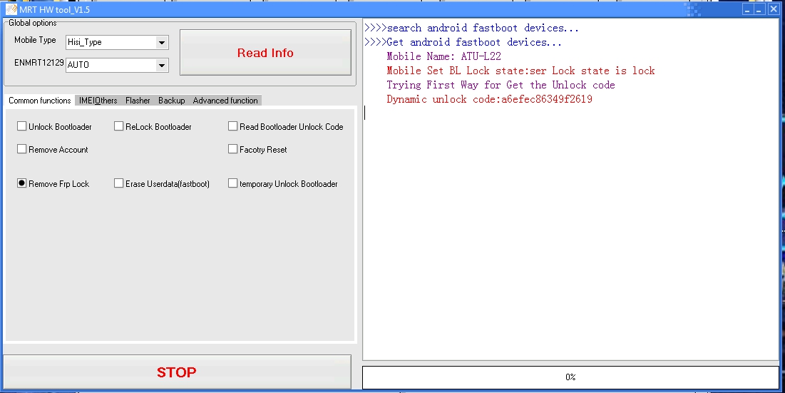

pag na read na
CLICK START

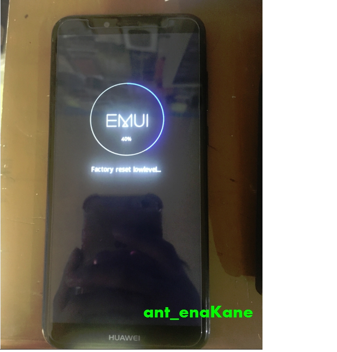

eto makikita sa unit
Done na
PS: nsa 15-20 min lang process nyan, pag tumagal dito
close and reopen mo lang mrt, off unit or restart lang pc mo
