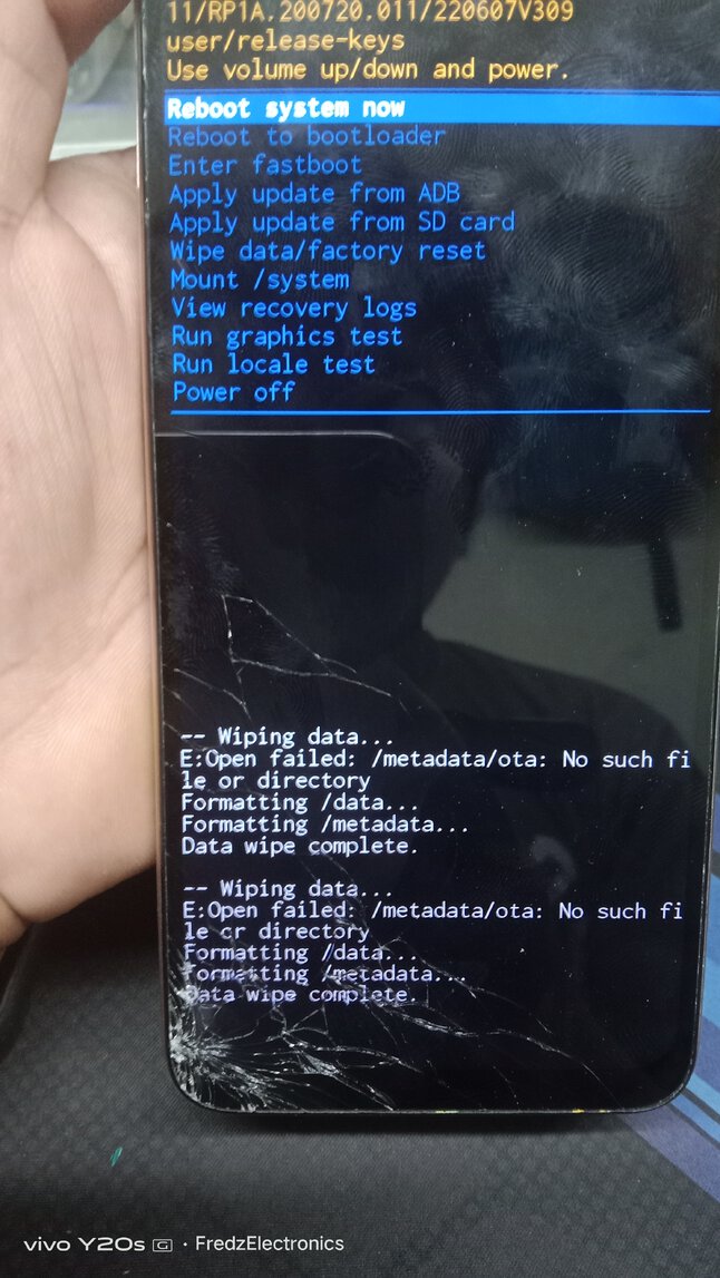

Una hard reset ko muna kung makuha sa HR lang. Pero pagkatapos ng HR waley,same issue.HR reset error.jpg
Kaya proceed na sa Flashing.

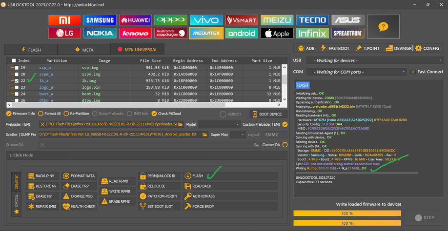

1. Open UT then Go to Mediatek Tab
2. Load the firmware
a. Preloader|EMI = preloader_x665b_h6222.bin
b. Scatter | DUMP File = MT6761_Android_scatter.txt
3.Click Backup NV to backup important data of the phone. Save it to a safe place for restoring later.
4.After Backup complete, click Flash to Begin Flashing.

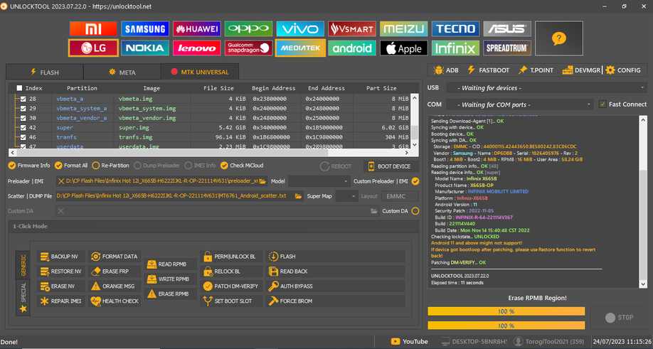

5.After Flash click Patch DM-Verify. Note, if it says Bootloader Lock error,click PERM|UNLOCK BL.
6.After successful unlocking Bootloader,click Patch DM-Verify again. It should report success.
7.Put check mark on Format All then click Flash again for the second time.
Just click "I Understand" to continue flashing the phone.
8.After Flashing, click RESTORE NV.
9.If the phone bootloop after restoring nv data, do step 5 and 6 again. it should work now.

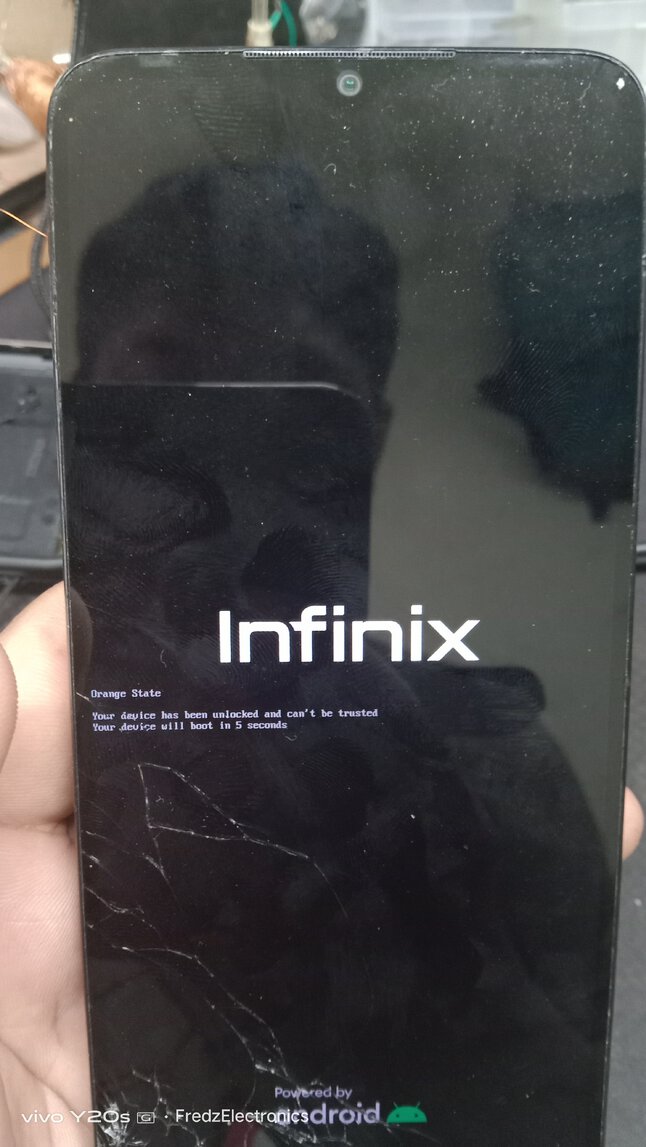

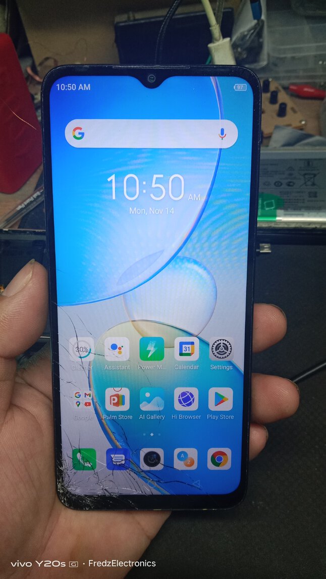

Pagkatapos ko ma-flash power on ko na ang unit with a smile. Kaso pagka-on ko may orange warning naman.

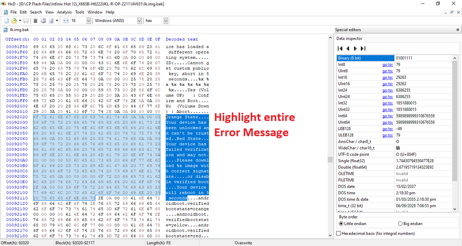

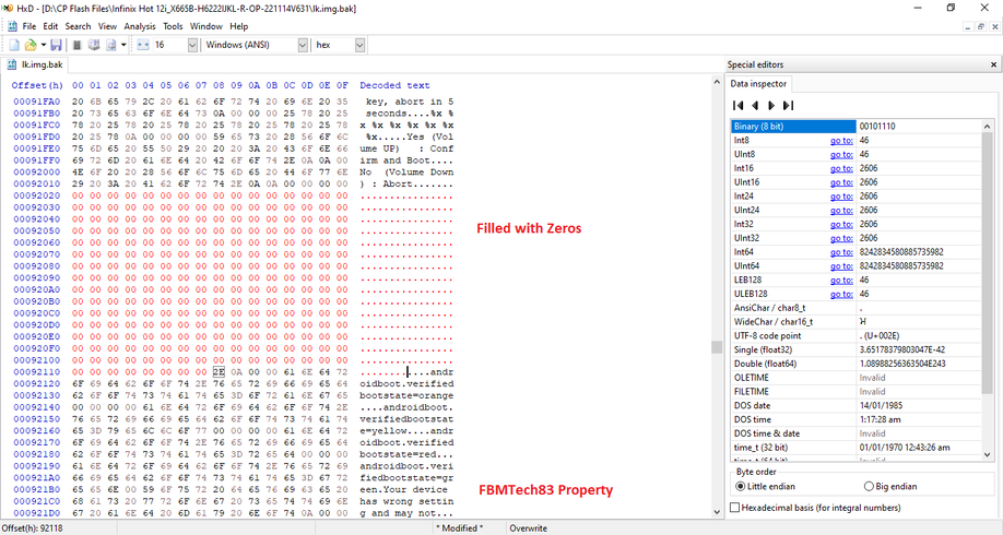

So next step ay i-clear ang error gamit ang HxD Editor.
1. Open HxD Editor tapos i-load ang lk.img mula sa folder ng Flash File mo.

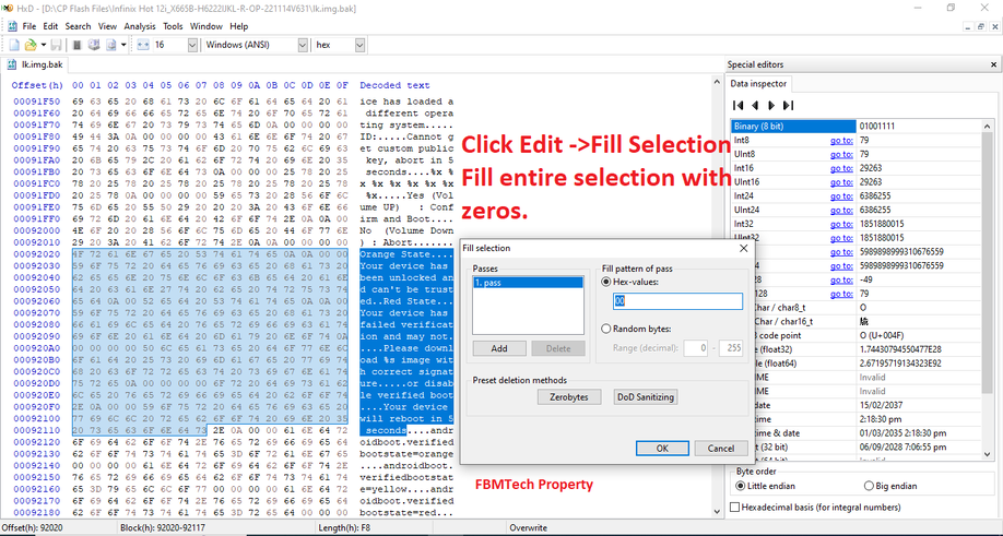

2. Click Search then type in Orange State, at mula sa orange state hanggang sa end ng error message e-highlight mo lang then Click Edit then Fill Selection,tapos Fill mo lahat ng zeros para mapalitan lahat ng zero yung naka-highlight.
3. Save mo na yung edited file,then Open mo ulit ang UT. Load mo yung firmware, uncheck mo lahat maliban sa lk.img.
4. Flash mo ulit, dapat yung lk.img lang mai-flash mo.

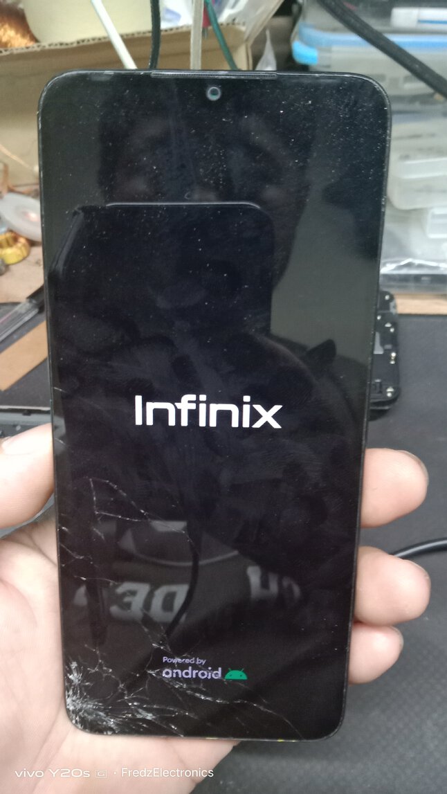

At eto na,tapos ang problema :)
No more error message sa booting.

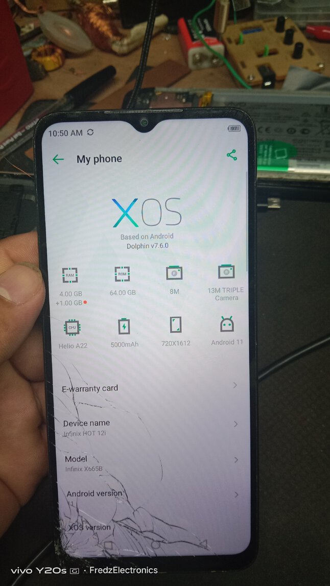

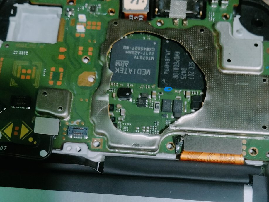

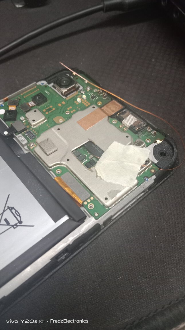

Eto nga pala ang TP nito pag mataas din ang Security Patch na tanggap nyo.
