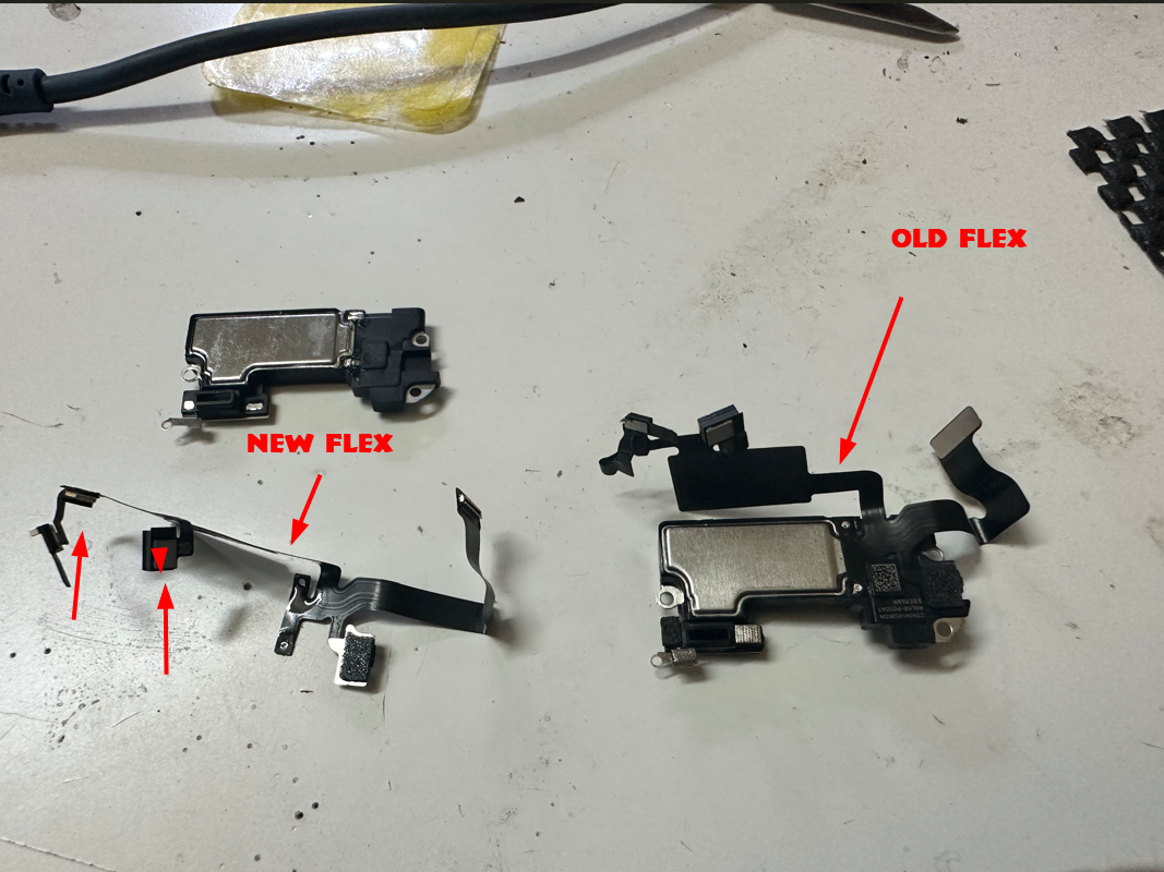

so nag decide ako na mag palit ng speaker set na
after on nag normal yong unit pero nag restart parin pero matagal na compare sa unang basis . at nag ka idia na ako kung bakit nag rerestart
so binalik ko yong original front speaker set to confirm at yon nag rerestart sya pero mas mabilis compare sa pag palit ko ng bagong set na speaker.
so ?

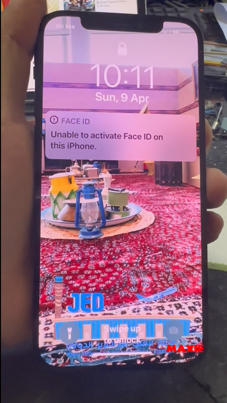

i check the original speaker at flex ng unit at nakita ko na nag malfunction yong orginal na speaker sometimes ok sometimes hindi
at kahit orginal na flex nakalagay unable to activate face ID on this phone nakalagay
Solution?
Remove all sensors from the original FLex then transfer to the new flex
  • Sensor
  • IFS
  • speaker

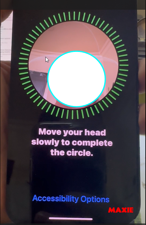

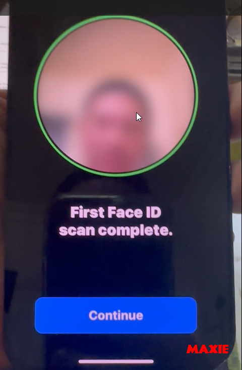

Done
  1. Restart Solve
  2. Unable to activate Face ID Solve
