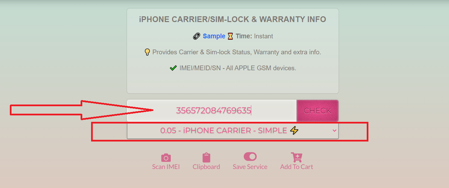

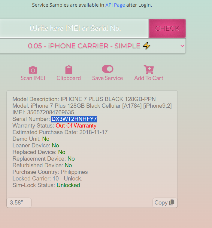

Punta sa sickw server Free lang
ilagay ang imei
makukuha mo na ang serial number

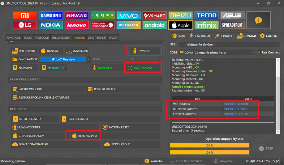

Run UNLOCKTOOL Software
PWNDFU
BOOTRAMDISK
READ HW INFO
Yun na nakuha mo na ang precious info
88:E9:FE:C6:6B:BF
88:E9:FE:CF:58:79
88:E9:FE:C3:81:40

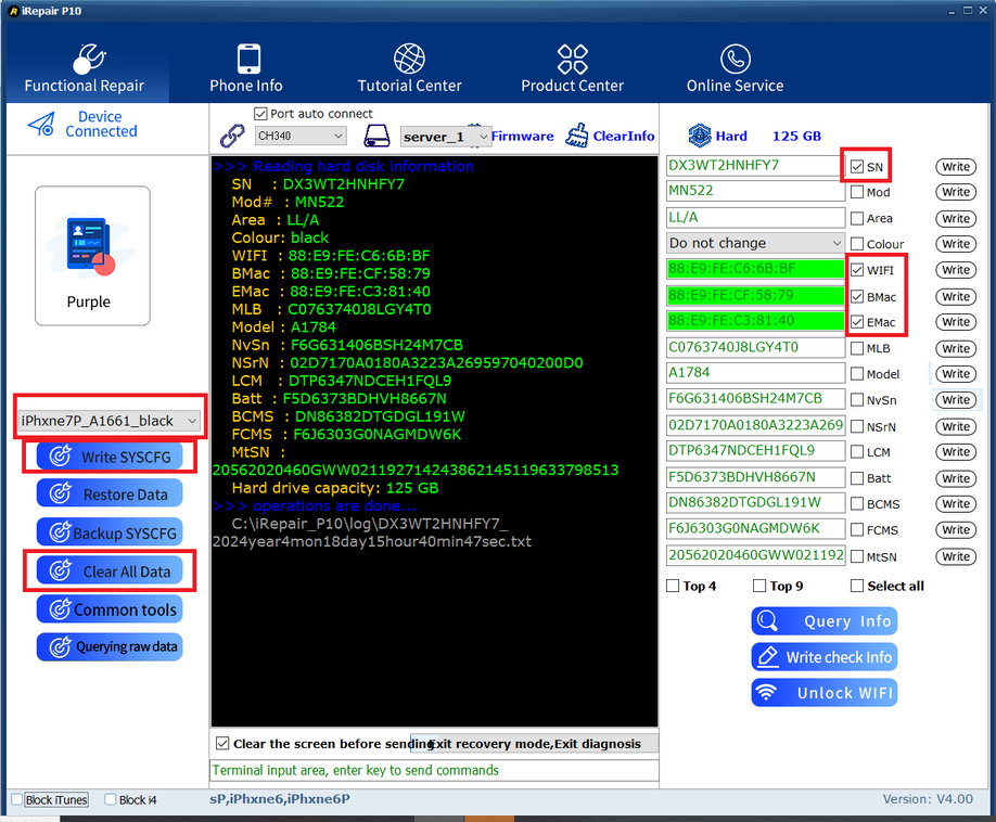

ilabas ang irepair tool mo na pang purple mode
put the unit into purple mode
Steps:
1) Select what model
2) Clear all Data
3) Write SYSCFG
4) lagyan ng check yung apat at ilagay yung info na nakuha sa UNLOCKTOOL at sa sickw
5) click write
exit Dahil Done na
ilagay ang imei
PWNDFU
BOOTRAMDISK
READ HW INFO
Wifi Address 88:E9:FE:C6:6B:BF
Bluetooth Address 88:E9:FE:CF:58:79
Ethernet Address 88:E9:FE:C3:81:40
Steps:
2) Clear all Data
3) Write SYSCFG
5) click write
exit Dahil Done na
