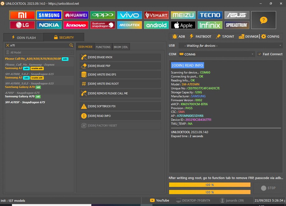

1. Check the binary version para sa gagamiting firmware. I used UnlockTool para ma check ito.
Boot into Download Mode > Connect to PC > Go to UnlockTool > Samsung > ODIN MODE > [ODIN] Read Info
2. Check the AP. Ang fifth digit from last ay ang binary version na kailangan mo para sa flashing ng stock firmware. (In my case, I need binary 5)

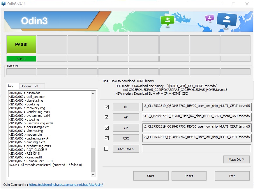

4. Boot into Download Mode again and flash the firmware using Odin.
Odin Download Link: https://mega.nz/file/IixwgBwD#DUBbKYvaddwoRlBkBJ9-INmSpB6Y7Ecet6RxJl9qDxs
Wait for the flashing to finish and pagkatapos nyan, automatic naka factory reset na ang A70 mo at FRP naman ang sunod mong gagawin.

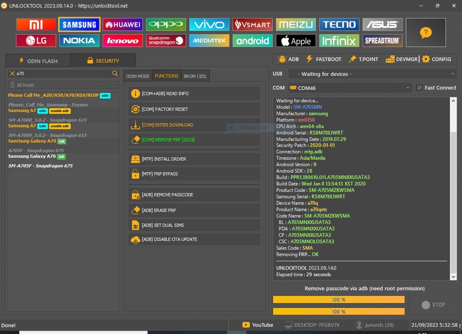

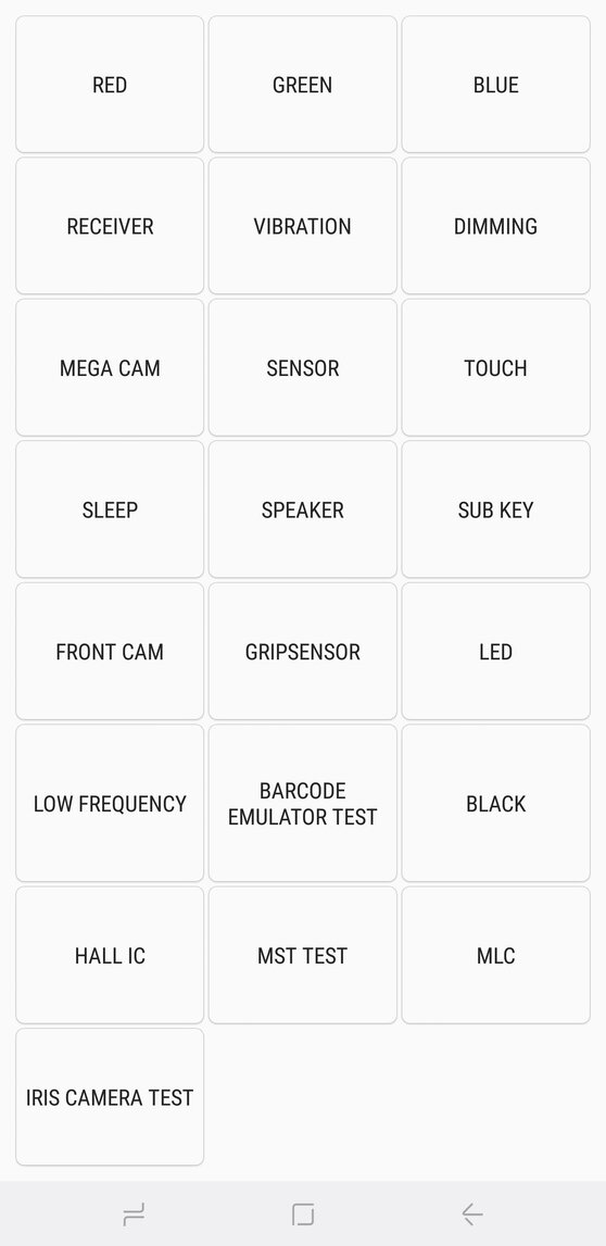

1. Go to Emergency Call and dial *#0*#
This should pop-up on your screen.
2. Balik sa UnlockTool, Punta naman sa FUNCTIONS > [COM] REMOVE FRP [2023] > Method 4 [All]
Allow USB Debugging when prompted and wait for the bypass to finish.
Samsung Galaxy A70 SM-A705MN Password and FRP Latest Security Bypass Done! ✅
