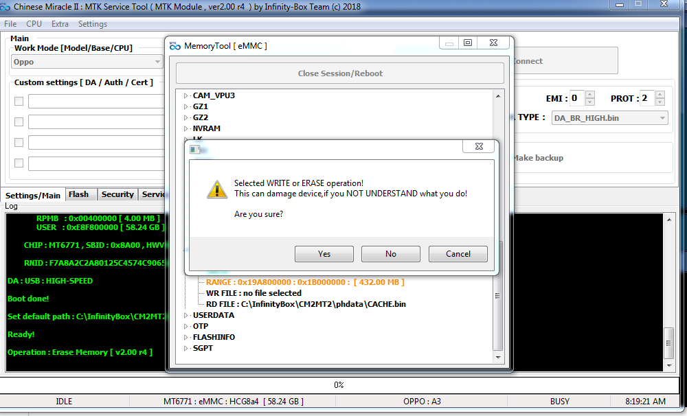

*HANG ON LOGO AFTER CODE/FRP REMOVAL
USE EMMC MEMORY TOOL AND ERASE "CACHE AND USERDATA" ONLY
-IF UNIT STILL BOOTLOOP/HANG TRY HARDRESETTING IT
-AFTER HR AND STILL THE SAME TRY FLASHING USERDATA AND CACHE ONLY WITH MY BACK UP

Maraming salamat boss....
hang siya tapos ganito nagpapakita...
tool download fail' blocking here; error code:0x99256658
boss ask ko lng sa akin ng error sa preloader, pero kung uncheck ko preloader ok nman flashing completed nman kya lng no power na ang unit nk 2 times n ako ng firmware same problem
cnu b pwede mgremote nk hang lng kc halos kilala ko na coder umiiwas sa logo lng

Done!
Elapsed: 00:06:46
*THIS IS MY FULL FRESH CM2 BACK UP AFTER THE UNIT IS A-OK:-bd
CPH1819 CM2 BACK UP
