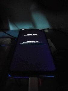

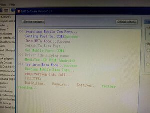

open mrt version 5.35
select oppo
select a3
tick format

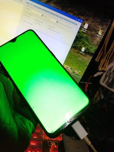

off your phone
hold up and down botton
connect cable
wait till lcd change to green
wait to reboot
after reboot
set up
then go to emergency
type asterispoundsign812poundsign then call
auto restart select engllish
done
select oppo
select a3
tick format
