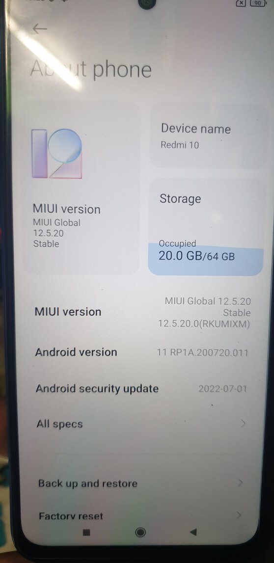

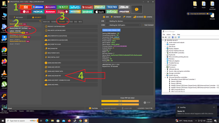

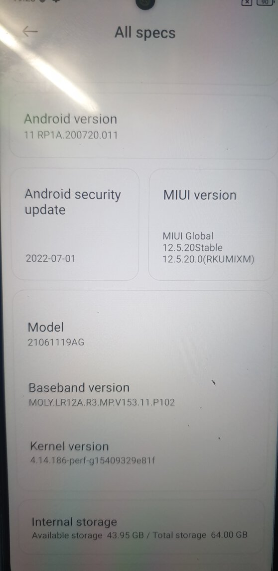

1.Open UnlockTool
2,Select Brand MI
3,Search Xiaomi Redmi 10 I 10 Prime brom

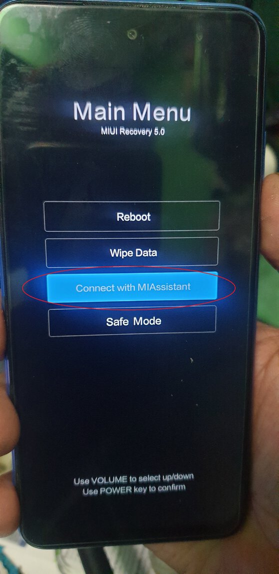

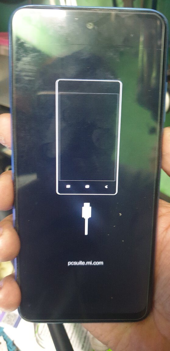

4, off Phone then press & hold volume up and power for recovery and choose the (Connect with MIAssistant) and Connect usb cable
5.Go to UT, Select: RECOVERY and Click [SIDELOAD] ERASE FRP and wait it finish
view My SS
1.Open UnlockTool
2,Select Brand MI
view My SS

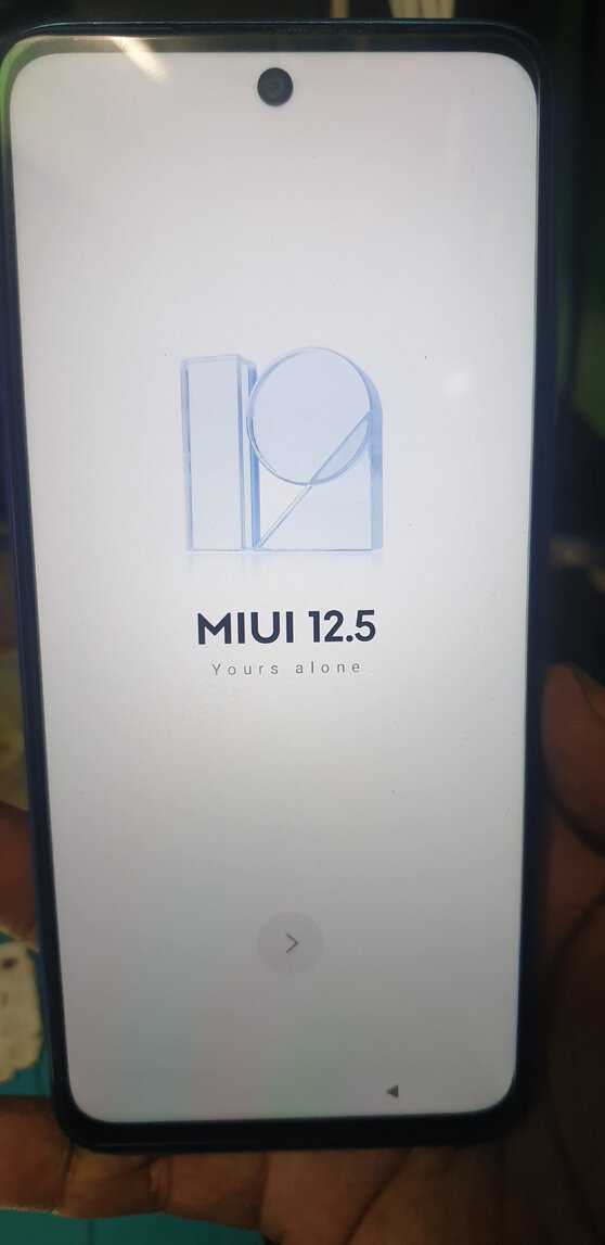

Working pa din siguro 5 minutes hininta ko lang matapos
