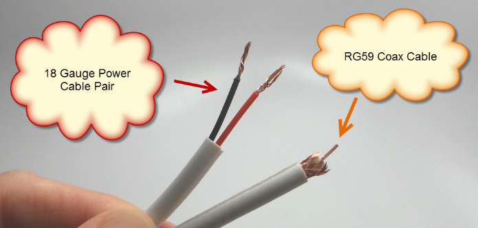

RG59 Siamese cable is a heavily shielded cable which contains an RG59 COAX cable for video and pair of 18 gauge 2 conductor power wires in one jacket. The advantages to using RG59 cable for CCTV camera installation is that it is more durable than most pre-made camera cables and can be run in long distances without interference. You can also cut each cable run to the exact length that you need which makes the cabling part of the installation neat.
The above picture shows a close-up of RG59 cable

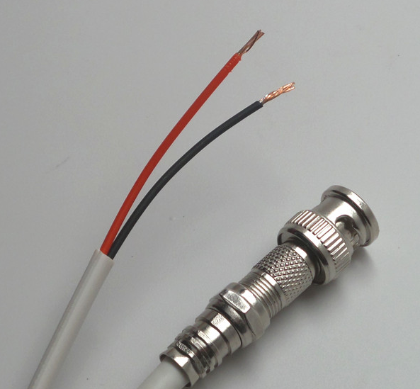

CCTV cameras (analog and HD types) and the surveillance DVRs that they connect to use BNC connectors for video input / output. CCTV cameras always have a BNC female as their video output and CCTV and HD surveillance DVRs almost always have a BNC female inputs for each video channel. This means that the installer must attach a BNC male connector to each end of the RG59 cable run.

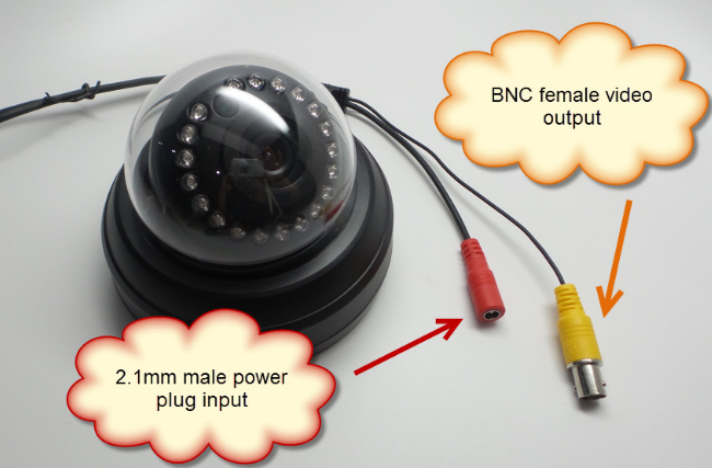

Most 12V DC security cameras (analog CCTV and high definition) have a 2.1mm DC power plug (male) connected to the power input of the camera. If you are using a 24VAC powered camera, dual voltage camera, or any camera that has a wire terminal block to connect power,

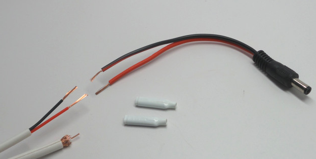

To connect the 18/2 power portion of the RG59 Siamese cable to a camera with a 2.1mm power plug, you must attach
https://forensicanthropologist.net/salary

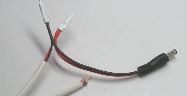

Butt connectors, B connectors, or another wire connector type of the installer's choice can be used to attach the 18 gauge power cables to the power lead.
This images shows the cable with a DC power lead attached using B connectors.

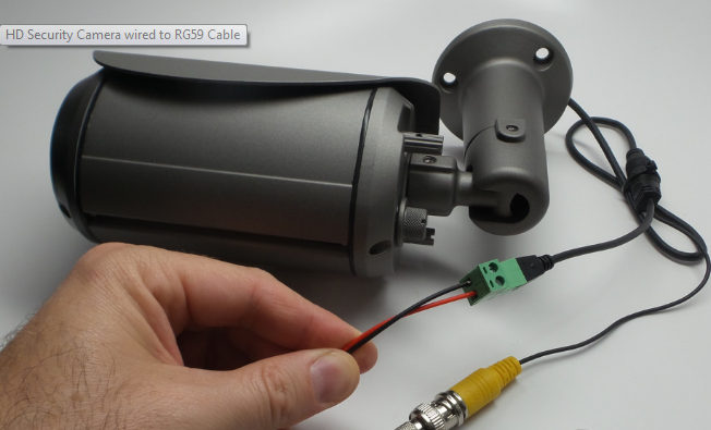

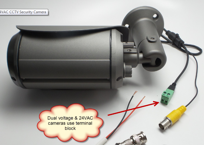

Using RG59 Cable with 24VAC or Dual Voltage Cameras
Most dual voltage security cameras (ones that can use a 12V DC or 24VAC power supply) do not have a 2.1mm plug attached to their power cable. Above is a dual voltage 1080p HD CCTV camera. Notice the power terminal block that is used instead of a 2.1mm power plug. The 18/2 power cables of the RG59 Siamese can attach directly to this terminal block by inserting into the slots, then securing the cable with screws.
This is what it looks like with the 18/2 cable attached to the power terminal block of the security camera.

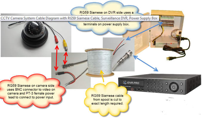

Here is a complete CCTV camera system cable diagram that uses a RG59 cable, a 1080p HD surveillance camera (12V DC powered), a hybrid HD / analog CCTV DVR, and a 12V DC multi-camera power distribution box.
The RG59 Siamese cable is cut to the exact length required.
On the camera side of the cable, a BNC connector is attached to the RG59 coax and a PT-3 power lead is attached to the 18/2 power cable.

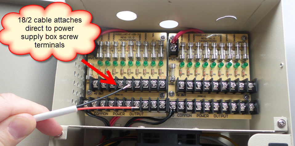

On the DVR side, a BNC connector allows the coax cable to connect to the video input of the DVR and the raw 18/2 power wire connects directly to one of the ports on the power supply box.
These steps are repeated for each 12V DC camera that your system uses.
