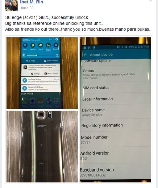

5). After flashing full flash files, inset any SIM card, phone boots up and go to WIFI and turn on. Go to Settings>>About>>SIM card status. You should see Status: Not allowed. Tab on "Update SIM card status" at the bottom of the screen then wait until it finished and reboot. Go back to SIM card Status again and see if it shows Status: Allowed. If it is, then you're good to go to the next steps.
6). Repeat Step 1,2, and 3, except in Step 3, enter phone's ORIGINAL IMEI. After all steps done, check to make sure you have original IMEI in phone now.
7). Now flash FULL flash files (BL,AP,CP,CSC) again. After flashing is done, phone should be now UNLOCKED.
