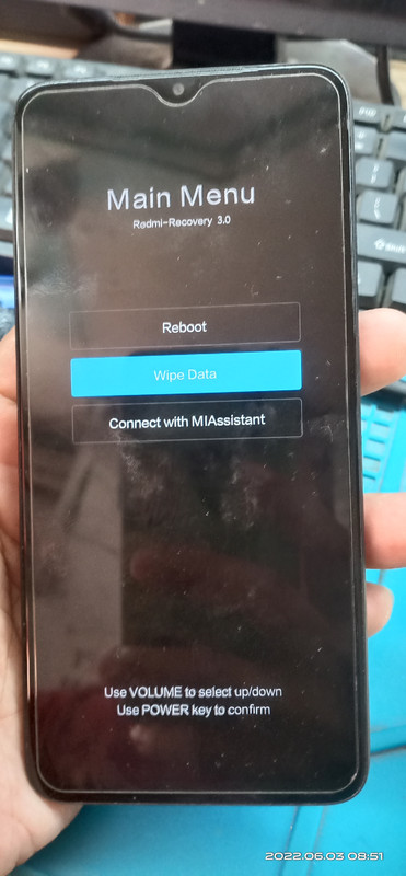

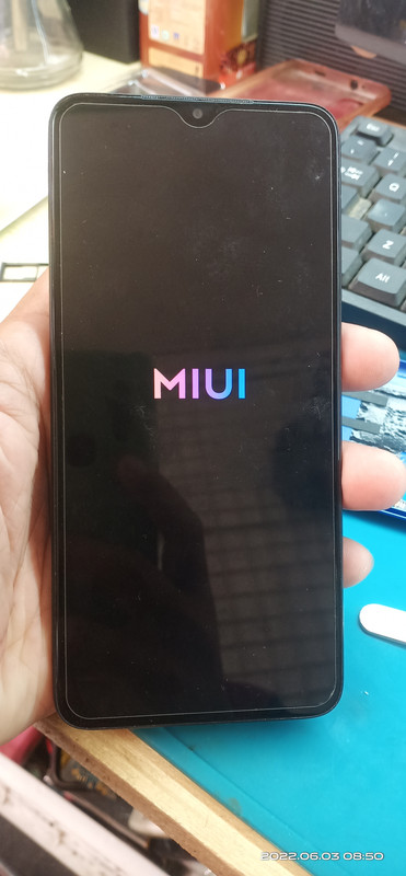

Hang on MIUI logo.
First Hard Reset by pressing Volume Up and Power switch.
Next is FRP Lock

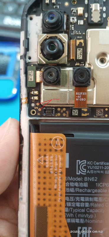

Disassemble unit for testpoint

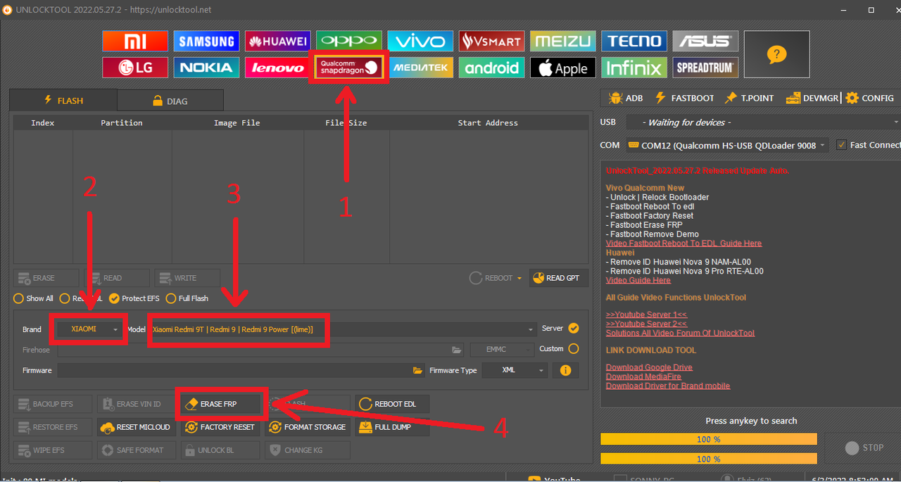

Qualcomm Driver: https://xiaomifirmware.com/download-link/?dlm-dp-dl=14092
UnlockTool Latest: https://www.mediafire.com/file/5j4h7em0h0fa2h2/UnlockTool-2022-05-27-2.exe/file
Open unlocktool
Choose Qualcomm Snapdragon
Select Brand Xiaomi
Select Model Redmi 9T
Remove Battery
Connect Testpoint

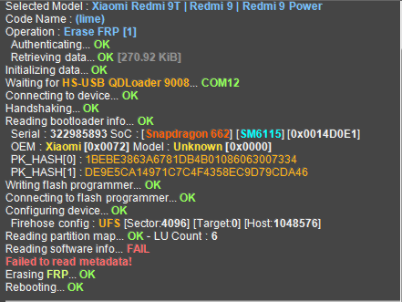

Insert USB cable

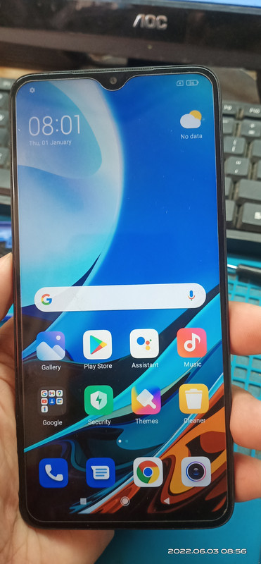

Done
