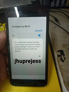

Model: Samsung j2 core (j260f)
Problem: Screen password & frp

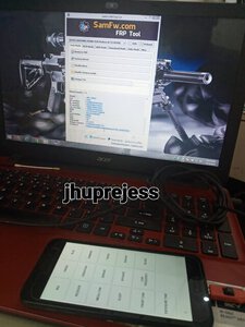

3.Download SamFwFRPTool.
4.Open SamFwFRPTool & connect c.p naka normal on.

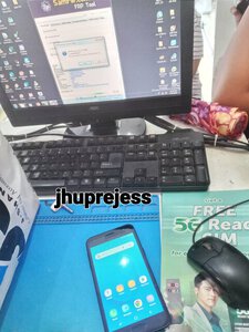

5.Click info & dial *#0*#
6.Tapos click Allow USB debugging.

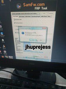

7.Click Remove FRP.
8.Smile & wait FRP remove successfully.
