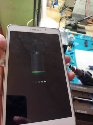

Not charging and dead batt issue..
Steps:

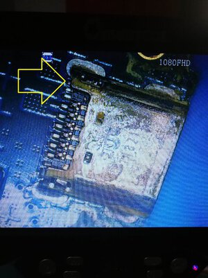

1. Check physical condition of charging pin. (Replace if there are signs of corrosion and pseudo soldered pins)

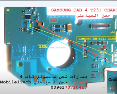

4. In this case I checked the capacitor in the reference charging ways photo. Voltage is below the required 5V.

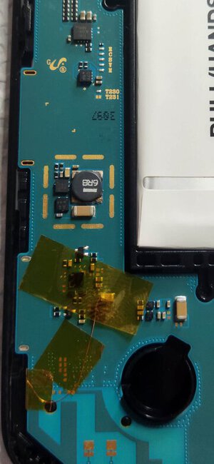

5. I had to put a jumper wire from the positive line of the charging pin to the capacitor included on the reference.
6. Since required voltage is now present, the charging line section is now complete.
