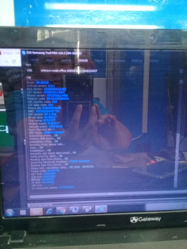

Operation: Read Codes

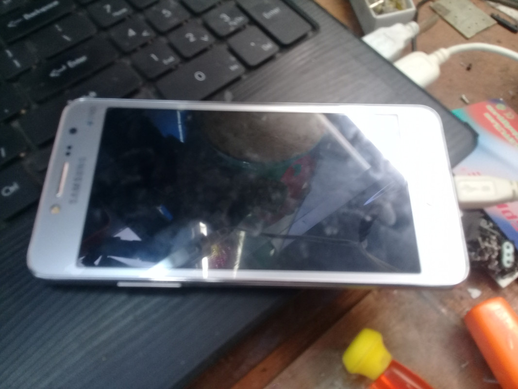

Selected model: SM-G532F
Software version: 34.3
Checking hash file... OK
Waiting ADB device... OK
Reading phone info...
Model: SM-G532F
Android version: 6.0.1
PDA version: G532FXWU1ARE1
CSC version: G532FOJV1ARE1
Phone version: G532FXXU1ARB1
Product code: SM-G532FZSDKSA
CSC country code: KSA
CSC sales code: KSA
Phone SN: RV8K90KADAD
IMEI: 352233104027793
HW version: MP 0.300
RF cal date: 20180917
Chip name: MT6737T
Modem board: MT6737T
Security patch: 2018-05-01
Boot Warranty bit: 0
SIM State: ABSENT,ABSENT
Rebooting phone... OK
Initialization zTool... OK
Running zTool, please wait...
Start... OK
Initialization... OK
Generate and check client proof... OK
Verify proof by client... OK
Reading data from phone... OK
Searching Ramdump interface... COM37 detected
Please wait, calculating codes... OK (time - 00:00:55)
Freeze code: 90850790
NET lock: 00000000
SUB lock: 00000000
SP lock: 00000000
CP lock: 46191620
SIM lock: --------
For check lock status: *#7465625#
Done with Samsung Tool PRO v.34.3
