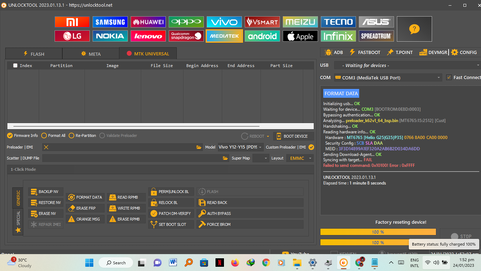

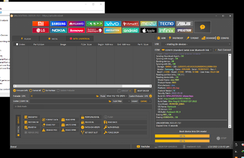

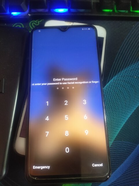

first attempt

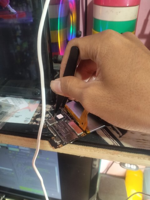

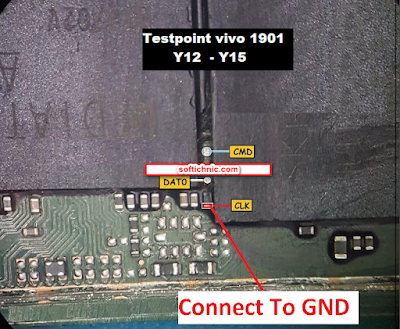

baklas phone para sa testpoint
open unlocktool
mediatek
check custom preloader/emi
select model vivo y12-y15
format data
testpoint
insert usb
na format pero pag on ko ng phone hindi natanggal ang password

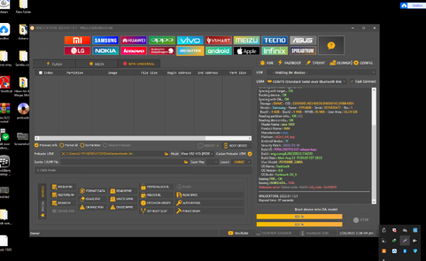

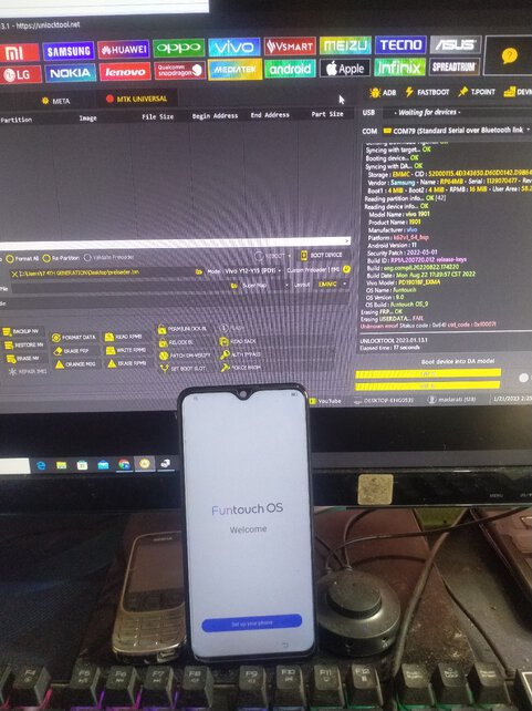

second attempt
open unlocktool
mediatek
select preloader link---https://www.mediafire.com/file/o28tkl37jzremt3/preloader.bin/file
format
testpoint
insert usb
nag failed sa user data pero success parin
first attempt
open unlocktool
mediatek
format data
testpoint
insert usb
second attempt
open unlocktool
mediatek
format
testpoint
insert usb

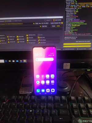

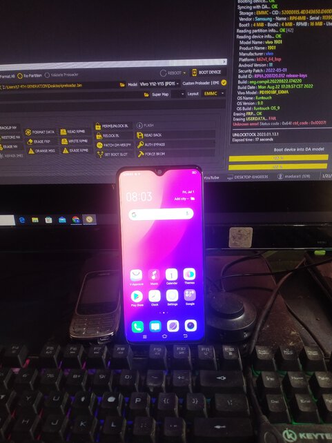

salamat idol
tested

aside sa custom preloader dobol check drivers reinstall and restart.clean location of testpoint for easy contact to ground.check usb cable and lastly ung tweezer dapat pointed tlga para accurate .
sa new version po ni ut no need preloader na po basta tp lang need...nag try ako na may prealoder nag ffail sya nang remove ko nag succsess nmn po
tested salamat;)

salamat sa bahagi..tested kkgawa ko lng no error...
