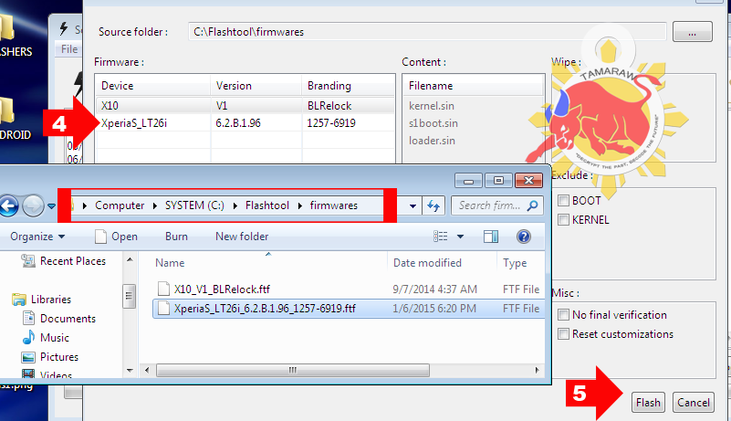

LT26i Firmware (IF you downloaded this with IDM it will be .zip, Just change .zip to .ftf and copy to c:\Flashtool\Firmwares\)
Flash Tool (Download and Install)
PROCEDURES:
1. Extract and install Flash Tool
2. Copy Downloaded Firmware to c:\Flashtool\Firmwares\
3. Open Flashtool

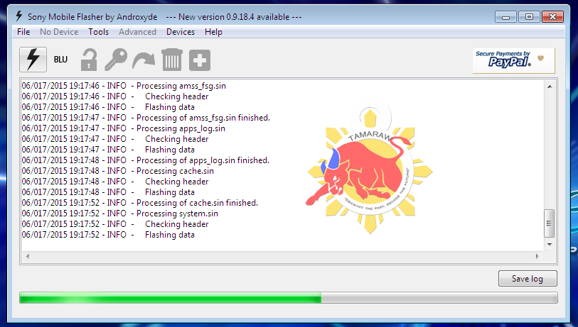

4. Click the ENERGY/THUNDER SIGN
5. Tick Flash Mode
6. Click OK
7. Select your device/Firmware
8. Click FLASH

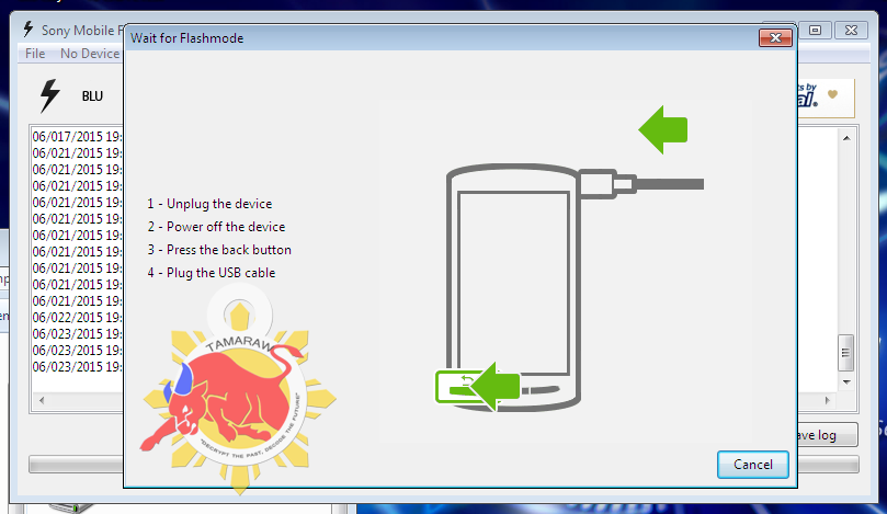

When you see this
9. Turn Off the Phone, Press Volume Down only then Insert USB Cable
Flasher will Flash your phone
10. When you see " Flashing Finished", Remove your phone from USB and power it on
Congrats, Your phone was Successfully Flashed.

Ang nakalimutan lang ilagay sa procedure ay yong dapat
pag-install muna sa drivers na matatagpuan lang sa Flashtool installation folder
na kadalasan ay nasa C:\Flashtool\drivers
Sa mga baguhan kasi na tulad ko ay magtataka tau kasi mag FAILED talaga
kapag hindi na-install ung drivers...
Un lang po napansin ko,
