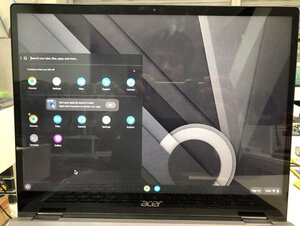

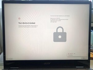

Acer Chromebook Spin 713
Procedure:
Read bios chip
from dump file find decode thru hxD
control F type devmode under Text-string tab
change the value
and do the same with enrollment
then save as clean.bin
Done
flash the clean.bin to bios chip
Viola
